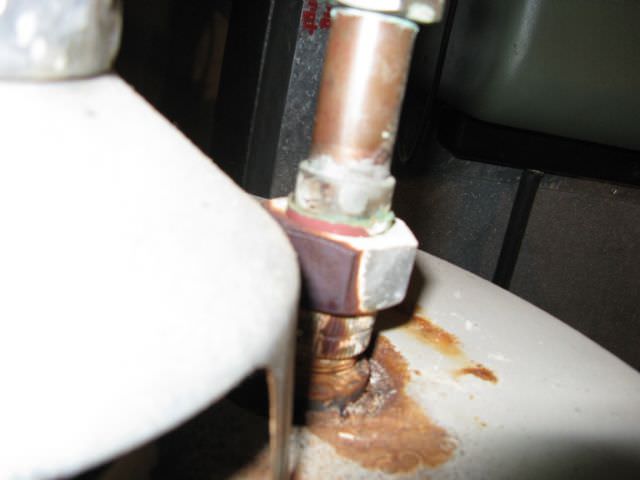

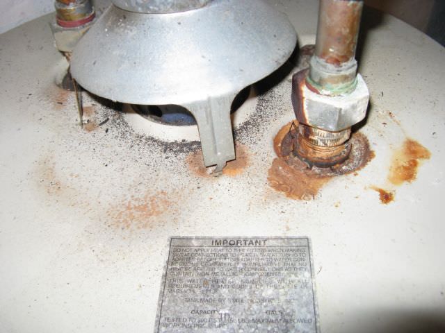

kccandfc Posted March 31, 2009 Report Share Posted March 31, 2009 Attached is picture of a charred dialectic union. I noted carbon debris and rusting on top of water heater and attributed this back drafting. Is the charring a sign of back-draft or another issue? Click to Enlarge 27.34 KB Click to Enlarge 52.38 KB Quote Link to comment Share on other sites More sharing options...
kurt Posted March 31, 2009 Report Share Posted March 31, 2009 That be backdraftin', mate. It's not "charring"; charring is reducing something to carbon or charcoal through incomplete combustion. That's just plain old rust and corrosion, caused by the corrosive moisture (I think it's the sulfur dioxide) in the combustion gas. Quote Link to comment Share on other sites More sharing options...
