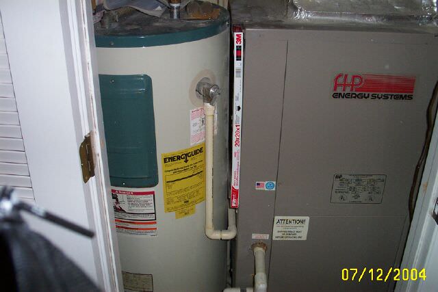

Danny Pritchard Posted July 12, 2004 Report Share Posted July 12, 2004 Found this today.I know it is wrong.I went to the FHP homepage hoping to get manufacturers recommendations for clear air space in front of the return grill.I was not able to find any.Is there a minimum clear space area in front of the return air that would apply to all units. Download Attachment: HVAC air space.jpg 62.18 KB Quote Link to comment Share on other sites More sharing options...

Danny Pritchard Posted July 12, 2004 Author Report Share Posted July 12, 2004 Crusty, No.It is a 1950's house that has been remodeled.Both water heater and airhandler are 7 years old. Quote Link to comment Share on other sites More sharing options...
crusty Posted July 12, 2004 Report Share Posted July 12, 2004 Is that filter on the side the return air inlet? Is this a category IV appliance? Never mind. I assume electric judging from the hot water heater. I'm not used to seeing those out here. I'll butt out now. Manufacturer's specs would rule. The door is most likely big enough to allow sufficient return air. 25% of the area of a wood louvered door is the rule of thumb for combustion air. Functionally it should apply here too for the return volume. Quote Link to comment Share on other sites More sharing options...
Terence McCann Posted July 13, 2004 Report Share Posted July 13, 2004 Looks like FHP is big in geo-thermal Danny. Tried finding some installation manuals, no luck. You know for sure that there is no where near enough room for sufficient return air stuffed that close to the h/w htr, what was the delta t on a/c mode? Manufactures also call for clearance on the front back and sides for servicing, yours looks way too tight. You would have to default to the manufacture specs. Is the plastic line on the TPR valve pvc or cpvc? Also, no more than 4 90's. Quote Link to comment Share on other sites More sharing options...
Danny Pritchard Posted July 13, 2004 Author Report Share Posted July 13, 2004 Terence, Yes it is a geo-thermal heat pump.I didn't check the delta t because one of the branch duct lines in the attic was broken off the main trunk line.A large portion of the cold air was cooling off the attic. Thanks for the comments. Quote Link to comment Share on other sites More sharing options...
