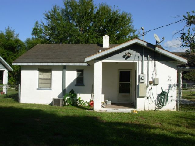

Lew49Fr Posted October 27, 2009 Report Share Posted October 27, 2009 CAn anyone tell me what kind of roof this is? asbestos, concrete board? probable date of install. Winter Haven , FL home. Click to Enlarge 23.21 KB Link to comment Share on other sites More sharing options...
Brandon Whitmore Posted October 27, 2009 Report Share Posted October 27, 2009 What year was the house built? Link to comment Share on other sites More sharing options...
Jim Katen Posted October 27, 2009 Report Share Posted October 27, 2009 CAn anyone tell me what kind of roof this is? asbestos, concrete board? probable date of install. Winter Haven , FL home. They look a lot like asbestos cement shingles. I'd guess that they date from the '50s or '60s. When was the house built? - Jim Katen, Oregon Link to comment Share on other sites More sharing options...
Lew49Fr Posted October 27, 2009 Author Report Share Posted October 27, 2009 What year was the house built? 1953 Link to comment Share on other sites More sharing options...
Jim Katen Posted October 27, 2009 Report Share Posted October 27, 2009 What year was the house built? 1953 Then the shingles are probably from 1953. Were they all in such good condition? Do you have any wider shots? - Jim Katen, Oregon Link to comment Share on other sites More sharing options...
Lew49Fr Posted October 27, 2009 Author Report Share Posted October 27, 2009 What year was the house built? 1953 Then the shingles are probably from 1953. Were they all in such good condition? Do you have any wider shots? - Jim Katen, Oregon Here is a view of the whole rear of the house. The shingles all look the same. They really do look good. I just have a hard time believing they are 56 years old! Click to Enlarge 55.46 KB Link to comment Share on other sites More sharing options...
