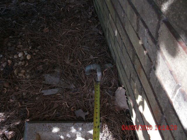

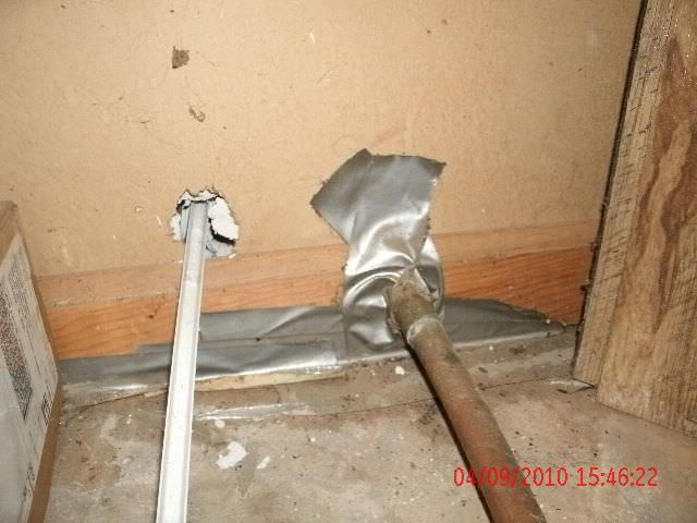

Phillip Posted April 10, 2010 Report Share Posted April 10, 2010 The pipe is hard to see, but the pipe runs up out of the ground then turns down. I would say this is trap in the line. Has there ever been a time this would of been approved. The house was built in 79. The water heater is a 2000 model. Click to Enlarge 76.68 KB Here is where it runs out the wall in the lower level of the house Click to Enlarge 51.96 KB Quote Link to comment Share on other sites More sharing options...
hausdok Posted April 10, 2010 Report Share Posted April 10, 2010 Nope OT - OF!!! M. Quote Link to comment Share on other sites More sharing options...
Nolan Kienitz Posted April 12, 2010 Report Share Posted April 12, 2010 Some of the early Fox & Jacobs homes in the DFW market had the TPR drain line set in the slab pour and routed out to exterior just as a straight horizontal shot. Quote Link to comment Share on other sites More sharing options...
Brandon Whitmore Posted April 12, 2010 Report Share Posted April 12, 2010 That set up makes it look like a breather pipe. Quote Link to comment Share on other sites More sharing options...
