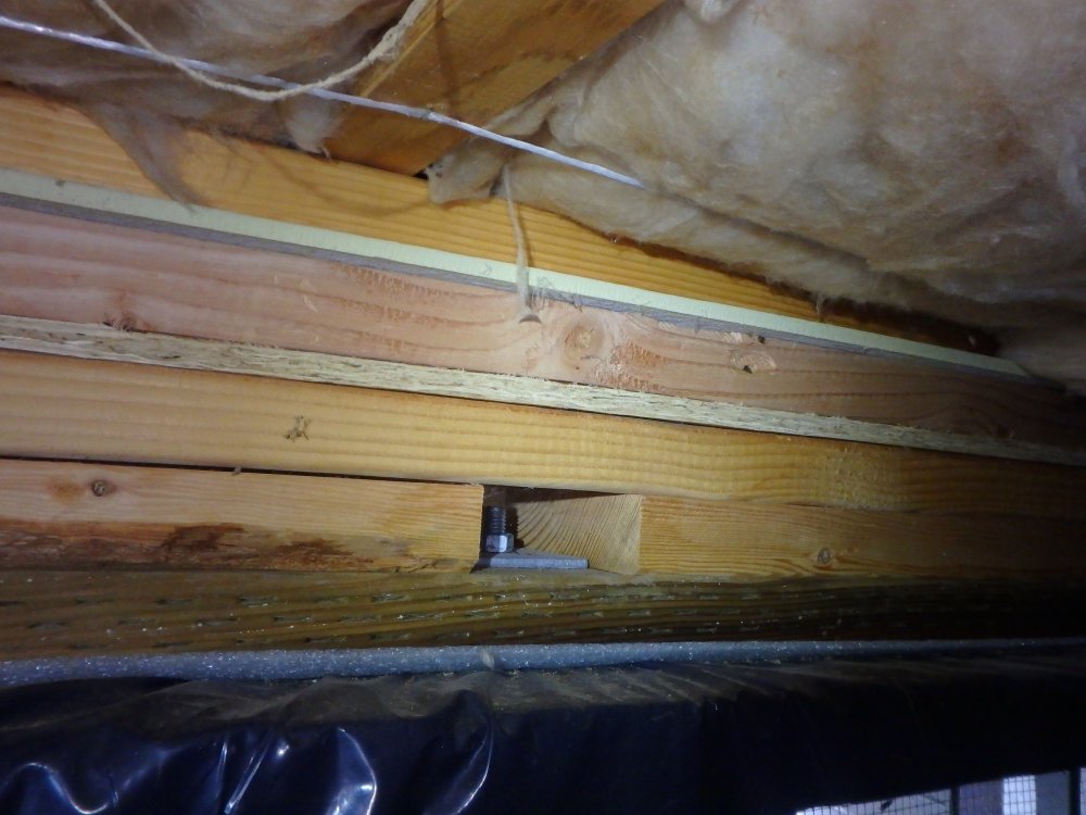

  1. Yes. That was another one of my concerns. The anchor bolts only secure the lowest PT sill plate to the foundation. Even with shear panels on the exterior wall, I would think that the strength of the connection between the foundation and framing has been compromised.
  2. That's basically what I said, in addition to including a comment from Hardie, "You cannot use our products as shims. Our products are not designed, tested or warranted for this type of application". The part I was a bit hung up on was what recommendation to make to the buyer. This is wrong, here is why, and... what? Ask the builder for documentation that this is an appropriate use of Hardie? They won't have that. Consult an engineer? They won't do that. I try not to kick the can down the road, but I wasn't sure how to avoid it here.
  3. I inspected a new home today. On top of the pressure treated 2x6 sill plate there were 4 additional 2x6 plates (presumably to get the sill plate up to the height of the floor system). Between 2 of these additional 2x6 plates, there was a continuous run of Hardie plank siding, used as a shim/spacer. This was a 2 story home with composite roofing (a substantial load was being transferred through the Hardie). I'm curious what others think of the fiber cement siding installed here and how they'd comment in their report. Additionally, any ideas why the builder would pour the foundation low and build up the sill to meet the floor joists?
