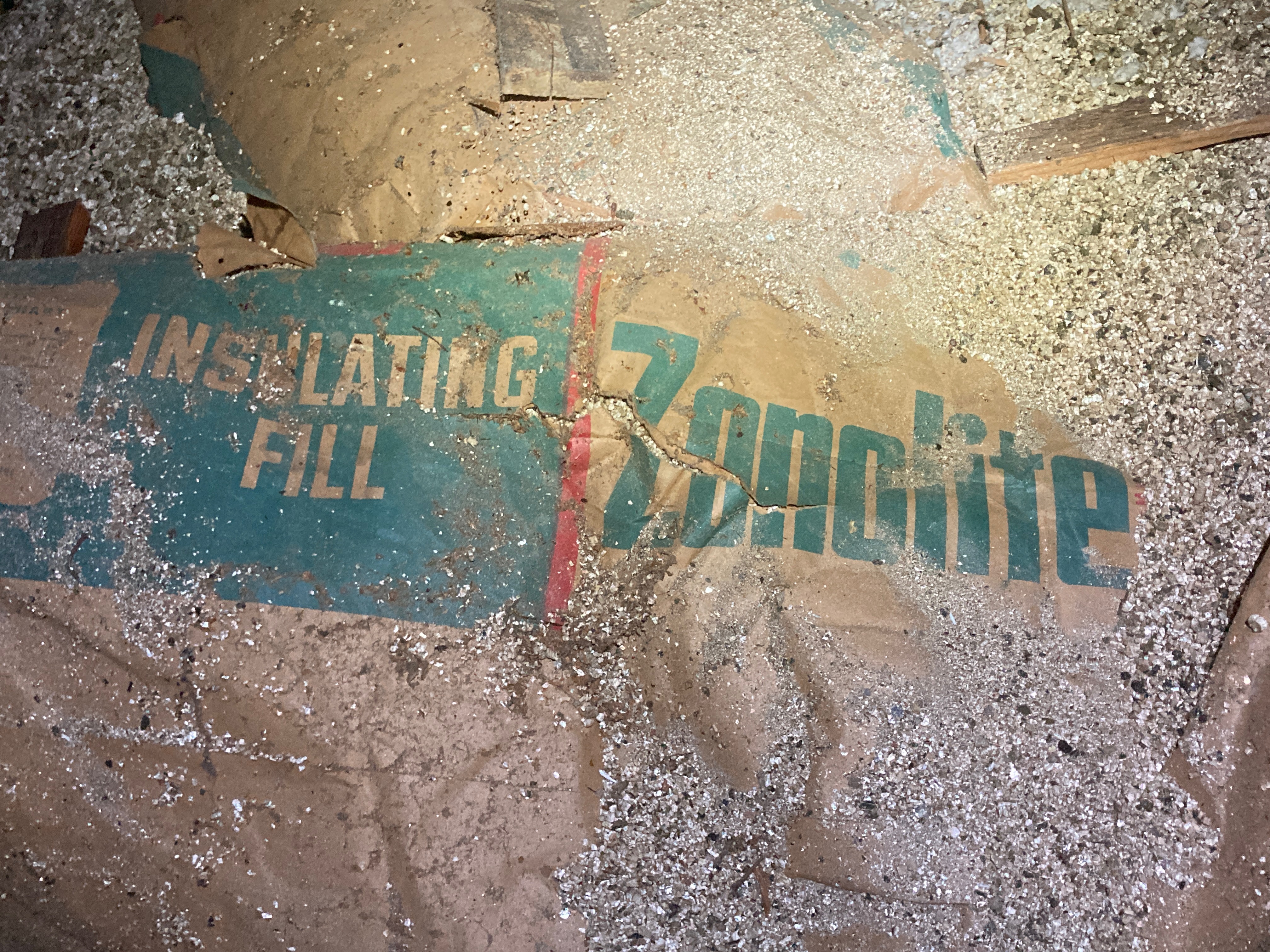

Is it safe to assume that Zonolite brand insulation does contain asbestos? Is it possible that an attic can be insulated with Zonolite and not be contaminated with asbestos? I mention the concern and direct clients to the Zonolite Attic Insulation Trust when I see the bags. But I'm curious for my own knowledge base.

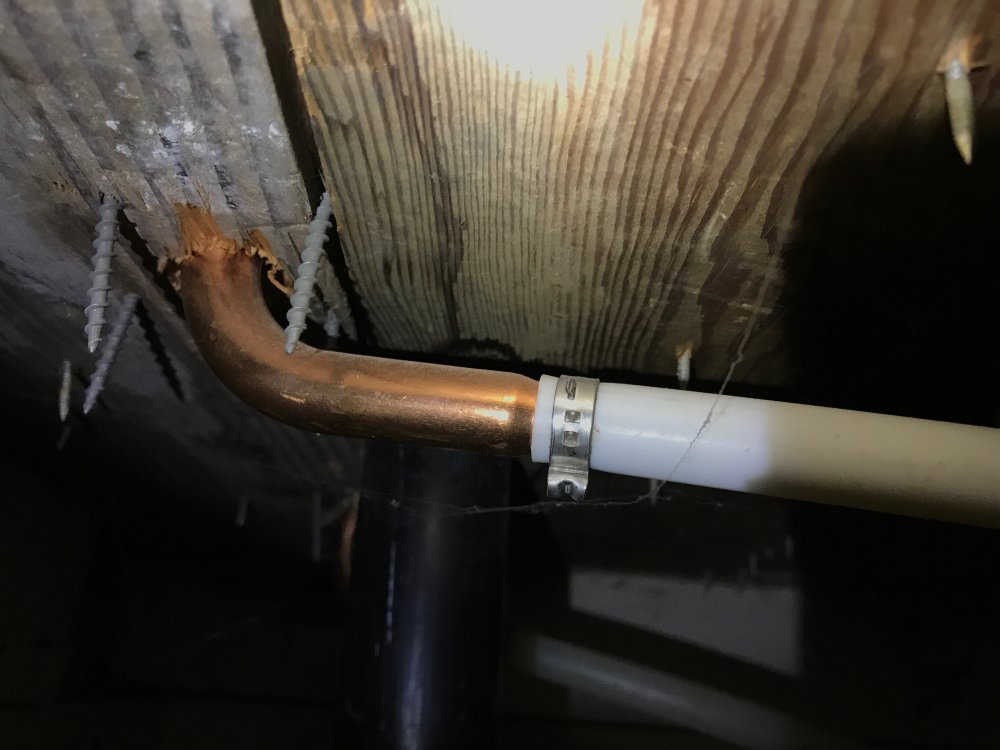

My gut says this isn't right. There's no transition piece between the copper and PEX, and it doesn't look like the tapered copper end is barbed like a proper male crimp fitting would be. Am I wrong? I can't recall ever seeing copper taper into PEX like this.
