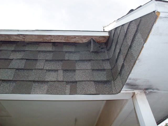

Marc Posted November 11, 2010 Report Share Posted November 11, 2010 Is there any prohibition against installing laminate strip shingles on a vertical surface? Click to Enlarge 50.28 KB Marc Link to comment Share on other sites More sharing options...
Rocon Posted November 12, 2010 Report Share Posted November 12, 2010 No there is not, however the issue they have is the tabs will not seal together. I have a project in Venice, CA installed in 2000 with no issues at all. Click to Enlarge 56.28 KB Link to comment Share on other sites More sharing options...
kurt Posted November 12, 2010 Report Share Posted November 12, 2010 We put them on dormer walls around here. They'll last forever. Link to comment Share on other sites More sharing options...
Brandon Whitmore Posted November 12, 2010 Report Share Posted November 12, 2010 They typically require hand sealing, and additional nails (such as for high wind areas). If you want to see pictures of what a wall/ roof? like that looks like when not fastened or sealed properly, let me know... Link to comment Share on other sites More sharing options...
Nolan Kienitz Posted November 12, 2010 Report Share Posted November 12, 2010 They wrap chimneys around here with them when the roof covering is replaced. About that time the veneer on the chimneys is pretty much worn as well. As KM noted ... they last forever. Link to comment Share on other sites More sharing options...
