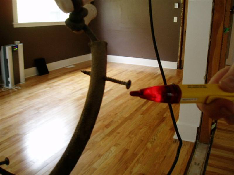

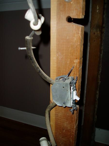

RobC Posted January 29, 2005 Report Share Posted January 29, 2005 Sorry about the focus, don't know what happened? Download Attachment: ElectK&TNScrew_M.JPG 34.75 KB Download Attachment: ElectK&TNScrew1_M.JPG 55.28 KB Link to comment Share on other sites More sharing options...
Rob Amaral Posted January 30, 2005 Report Share Posted January 30, 2005 Nice photo. One of the 'cons' about K&T, eh? (Remodeling activities over the years increases the chances for a nail or screw to penetrate the insulated jacket and lead to a possible 'ground fault' that cannot be 'cleared' by an overcurrent device). Link to comment Share on other sites More sharing options...
