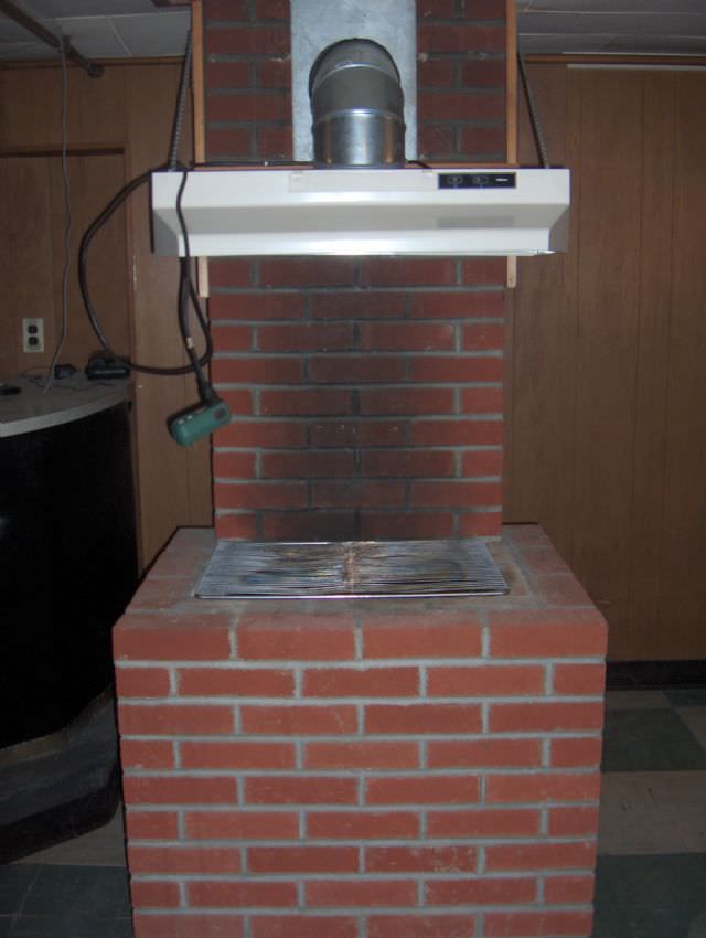

allseason Posted April 17, 2011 Report Share Posted April 17, 2011 Holy s--t, this takes the prize. It's an indoor fire pit in a basement with its own chimney along with draft assist from a kitchen exhaust fan. It shows signs of being used. Now I know why it was an estate sale. Click to Enlarge 56.5 KB Quote Link to comment Share on other sites More sharing options...
Terence McCann Posted April 17, 2011 Report Share Posted April 17, 2011 I've seen a few of those in the basements of homes around here. I state not to use them. Not too long ago one of the local news stations had a report of a couple that performed the procedure known as Death by Hibachi. Wouldn't be cool to put your family to sleep while char-broiling mutton in your basement. Quote Link to comment Share on other sites More sharing options...
allseason Posted April 17, 2011 Author Report Share Posted April 17, 2011 Here's how I reported it. Remove this. It is a hazard. Quote Link to comment Share on other sites More sharing options...

Inspectorjoe Posted April 18, 2011 Report Share Posted April 18, 2011 I've seen a few indoor charcoal grills, but nothing like that brick structure. It looks like somebody built it from plans meant for an outdoor BBQ. When I see one, of course, I tell people not to use it. Even if when in use, every bit of the combustion gases gets sucked away, you'd be SOL if the power went out and the fan stopped working. In the town I grew up in, there was a neighborhood bar/restaurant that had an indoor charcoal grill. It was huge, about 6 X 5 feet, and it was right in the dining area. Frinzi's Charcoal Pit had the best steak sandwiches I've ever had. It was a single piece of steak on a hard roll, smothered with chunks of onions. It just might be worth the risk of asphyxiation if I could recreate that sandwich at home. Click to Enlarge 51.15 KB Quote Link to comment Share on other sites More sharing options...
