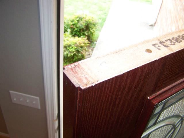

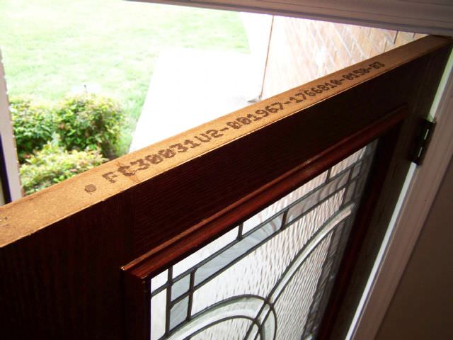

kimball gray Posted April 20, 2011 Report Share Posted April 20, 2011 Looks like a particle board interior with a wood veneer? i could not find any thing on the www by using the codes at the top of the door. do you just call it a wood door with glass? Click to Enlarge 49.66 KB Quote Link to comment Share on other sites More sharing options...
Ben H Posted April 20, 2011 Report Share Posted April 20, 2011 Are you sure it wasn't a fiberglass door? Looks like particle to me as well. Quote Link to comment Share on other sites More sharing options...
kimball gray Posted April 20, 2011 Author Report Share Posted April 20, 2011 not sure. closer view attached Click to Enlarge 38.36 KB Quote Link to comment Share on other sites More sharing options...

gtblum Posted April 21, 2011 Report Share Posted April 21, 2011 That looks like a Therma-tru fiberglass door to me. If it is, I believe the core is a high density foam Quote Link to comment Share on other sites More sharing options...
Tom Raymond Posted April 21, 2011 Report Share Posted April 21, 2011 It is a Therma Tru Fiberclassic fiberglass door. The top and bottom rails are composite similar to the original Trex decking, while the stiles are gluelams under solid oak. The core is foamed in place polyurethane. The skims are a proprietary fiberglass molded at around 200 degrees and under several hundred tons of pressure, IIRC, it's been years since I toured the factory. Quote Link to comment Share on other sites More sharing options...

hausdok Posted April 21, 2011 Report Share Posted April 21, 2011 I'd simply call it a Fiberglass-Clad - thus the FC in the code - door. ONE TEAM - ONE FIGHT!!! Mike Quote Link to comment Share on other sites More sharing options...
Tom Raymond Posted April 21, 2011 Report Share Posted April 21, 2011 Look at the first pic. The FC stands for Fiber Classic, the series designation. The 30 is the model designation for the slab. Some portion of the remaining numbers indicate the level of prep the slab received at the factory before being shipped off to the assembler, while the rest are factory tracking numbers for production date and lot numbers for the foam and glass was used to make it. One of the advantages of a decade of building material sales is having access to factory tours. The disadvantage is the terabytes of useless information stuck in my head. Quote Link to comment Share on other sites More sharing options...
