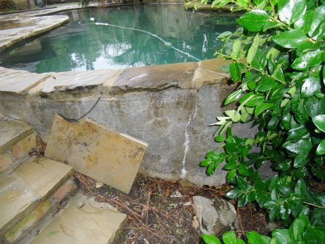

charlieb Posted September 30, 2011 Report Share Posted September 30, 2011 23 year old pool with the original (poor condition) gunite plaster surface. This is the first time I've ever seen the back side of the shell so seeing the efflorescence is disturbing. What say ye? Click to Enlarge 85.99 KB Click to Enlarge 67.66 KB By the way, the photos were taken at the max rez and reduced for this forum. Can everyone make the details out ok? Quote Link to comment Share on other sites More sharing options...
rkenney Posted September 30, 2011 Report Share Posted September 30, 2011 What is your concern? My understanding is that the shotcrete is porous anyway, the plaster is the waterproof liner (expected life 20 yrs) and needs to be replaced. The concrete is reinforced and as long as you keep the pool water out of it the crack you show doesn't look that bad. The efflourescence could indicate some seepage at that crack for a while or exposure (rain) collected along the crack. Does the pool leak there? Gross oversimplification, as I don't know all the steps involved. Recommend further evaluation. Quote Link to comment Share on other sites More sharing options...
charlieb Posted September 30, 2011 Author Report Share Posted September 30, 2011 No leaks noted. It is my hypothesis there is some seepage at the cracks. The cracks are tight ie not open. Keepem coming guys and thank you Bob. Quote Link to comment Share on other sites More sharing options...
rkenney Posted September 30, 2011 Report Share Posted September 30, 2011 Of course I did neglect to mention that the coping doesn't look like its coping very well. Quote Link to comment Share on other sites More sharing options...

kurt Posted October 1, 2011 Report Share Posted October 1, 2011 The first pic looks like all the cracks are coping related. I'd be as suspect of the coping as the pool liner. I'd probably also tell them it's time to think about relining the pool interior. Referring pool stuff to pool guys is smart though. It's one of the few things I tend to get real nervous about, as I don't look at enough of them to feel confident. Quote Link to comment Share on other sites More sharing options...
charlieb Posted October 1, 2011 Author Report Share Posted October 1, 2011 I reported what I have conveyed as well as more. The ball was also punted but the client asked if I would solicit opinions from my piers. The pool guys in the area are not..................well of the highest caliber. Thanks for the input. Quote Link to comment Share on other sites More sharing options...
