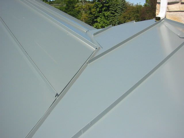

Inspectorjoe Posted May 8, 2012 Report Share Posted May 8, 2012 This isn't a weekend warrior installation. Unbelievably, it's new construction. I swear this is not Photoshopped. Click to Enlarge 26.47 KB Link to comment Share on other sites More sharing options...
Tom Raymond Posted May 8, 2012 Report Share Posted May 8, 2012 If the cricket and the valley it creates are covered in IWS and that is a real W valley pan with edge dams it should work just fine. If not it's screwed, the cricket looks way to shallow a pitch for standing seam without a membrane under it. An open valley with soldered flat lock seams would be better, but it would be just as ugly. Even a custom pan would look goofy, and most roofers wouldn't be able to fab it anyway. Link to comment Share on other sites More sharing options...
Inspectorjoe Posted May 9, 2012 Author Report Share Posted May 9, 2012 You don't have a problem with the water being trapped, Tom? That's the most idiotic roofing detail (both design and installation) I've seen in a long time. Link to comment Share on other sites More sharing options...
