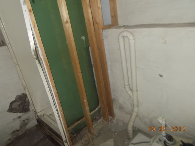

AmeriSpecguy Posted October 25, 2012 Report Share Posted October 25, 2012 I'm having issues trying to figure out exactly what's going on here. In the photo you'll see a loop vent in between a toilet and shower. No DWV were noted on this side of the house. The stack was about 10-12 feet from this loop. Is this supposed to be venting the shower? Click to Enlarge 28.68 KB Link to comment Share on other sites More sharing options...
Garet Posted October 25, 2012 Report Share Posted October 25, 2012 That's not venting anything. Look at a Code Check book for a foot (island) vent configuration. Link to comment Share on other sites More sharing options...
