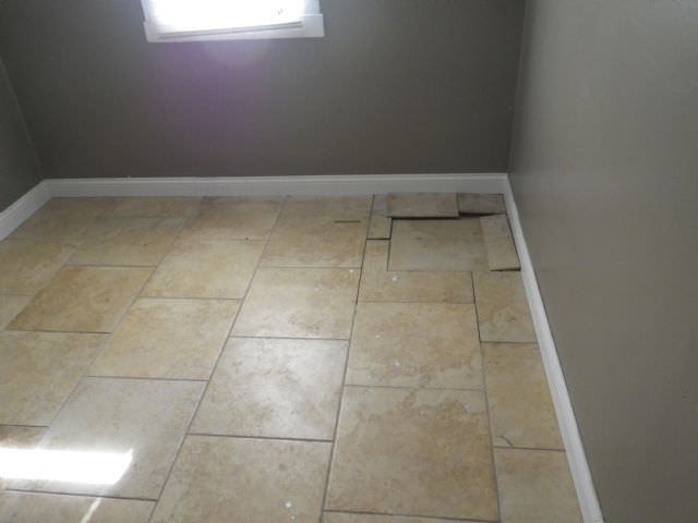

Mark P Posted November 29, 2012 Report Share Posted November 29, 2012 This house was built around 1940 and has a very large cisten under one of the bedrooms. The top of the cisten is cement, same as the walls, except for a small access panel in the bedroom floor. I told my clients that other then just being creepy I can offer no meaningfull advice on it. So does any one have any useful advice on this situation...? Click to Enlarge 50.81 KB Click to Enlarge 26.83 KB Quote Link to comment Share on other sites More sharing options...
Inspectorjoe Posted November 29, 2012 Report Share Posted November 29, 2012 Is there a basement? A doorway could be cut to make it into a useable room. I see that done all the time. If it had to stay as it is, I'd probably recommend pumping out the water, drying it out completely (somehow), and securing the lid so a kid couldn't possibly get it off. Quote Link to comment Share on other sites More sharing options...
Mark P Posted November 29, 2012 Author Report Share Posted November 29, 2012 Yes there is a basement of sorts, dirt floor, 5 foot ceiling... Quote Link to comment Share on other sites More sharing options...
Garet Posted November 29, 2012 Report Share Posted November 29, 2012 I would definitely comment on the potential for a kid to find their way in there. Quote Link to comment Share on other sites More sharing options...
hausdok Posted November 29, 2012 Report Share Posted November 29, 2012 Wow, Now that has potential for the fellow with a mother-in-law that's a royal pain in the butt; man in the iron mask potential. Bwahahahahahahahaha! ONE TEAM - ONE FIGHT!!! Mike Quote Link to comment Share on other sites More sharing options...
Tom Raymond Posted November 29, 2012 Report Share Posted November 29, 2012 Looks like an optimal place for a grow; isolated, semi-secure, and irrigated. You definitely need to advise them to dry it out and secure the lid. Joe's idea for the basement access is a good one, but in my experience sealing the water source is difficult and opening the cistern introduces a new leak into the basement. The last one I ran across originally supplied water to 3 homes. It had a 4" overflow that couldn't keep up with the spring supplying it. Quote Link to comment Share on other sites More sharing options...
Mark P Posted November 29, 2012 Author Report Share Posted November 29, 2012 Yea - it was surely creapy; we joked about the bodies and the drug lab stuff... They are looking to buy the house as an investment. This is what I put in the report: "FYI: There is a large cistern under the front right bedroom; the cistern is as large as the bedroom and deeper. Cisterns were used to collect rain water and the water was mainly used for washing. It looks to have about 3 feet of water in it. There may have been a pump in the basement at one time, but there is nothing now. All I can tell you is having it under the house is very unusual (in my experience - only the 2nd one I?ve seen in 8 years); that I have no expertise with this situation and can offer no useful advice on it on what to do about it. Obviously if this is going to be a rental property or if kids are every going to be in the house the access needs to be sealed up tight." Quote Link to comment Share on other sites More sharing options...
Tom Raymond Posted November 29, 2012 Report Share Posted November 29, 2012 If there is 3' of standing water in there and no means to evacuate it I would report that as if it were a flooded basement. There is more remediation needed there than just the hatch. Tenants won't complain about the building until that bedroom begins to fill with water. Quote Link to comment Share on other sites More sharing options...
