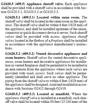

Richard Moore Posted February 25, 2013 Report Share Posted February 25, 2013 I only have the Seattle 2009 version of the IRC handy, but I don't think it's much different from the national codes. Anyway, G2420.5.2 would seem to indicate that the appliance shut-off valve can be elsewhere. Not saying it's a good idea, but....? Click to Enlarge 61.76 KB Quote Link to comment Share on other sites More sharing options...
Hearthman Posted February 25, 2013 Report Share Posted February 25, 2013 Vented logs must be listed to either ANSI Z21.84 or Z21.60. Either type can be left 'off' at the appliance and a remote shutoff as I described used seasonally. If there is no control valve on the burner itself and it is merely a burner connected to the gas supply then this is not allowed by the IRC. Most all such questions can be answered when you provide the make and model of the appliance in question. If there is no rating plate, you already have your answer-recommend removal. Refer to IRC R2420.5.2 for the remote shutoff allowance for fireplaces only. All other appliances must have an approved shutoff within 6ft in same room with "access". Quote Link to comment Share on other sites More sharing options...

kurt Posted February 25, 2013 Report Share Posted February 25, 2013 I only have the Seattle 2009 version of the IRC handy, but I don't think it's much different from the national codes. Anyway, G2420.5.2 would seem to indicate that the appliance shut-off valve can be elsewhere. Not saying it's a good idea, but....? Click to Enlarge 61.76?KB Strange. I'm sticking with 5.1. Quote Link to comment Share on other sites More sharing options...
Hearthman Posted February 25, 2013 Report Share Posted February 25, 2013 A shutoff valve is NOT an emergency shutoff---it is for service. Each appliance must have its own separate control, whether a manual control similar to a range top, millivolt valve with a standing pilot or electronic ignition. Being in the hearth industry, I don't see why all the paranoia as long as their is an appliance valve attached directly to the burner. Would I prefer a key valve next to the fireplace or an approved shutoff inside the fireplace? Sure, the code allows it to be remote. Check local codes, too. Quote Link to comment Share on other sites More sharing options...
