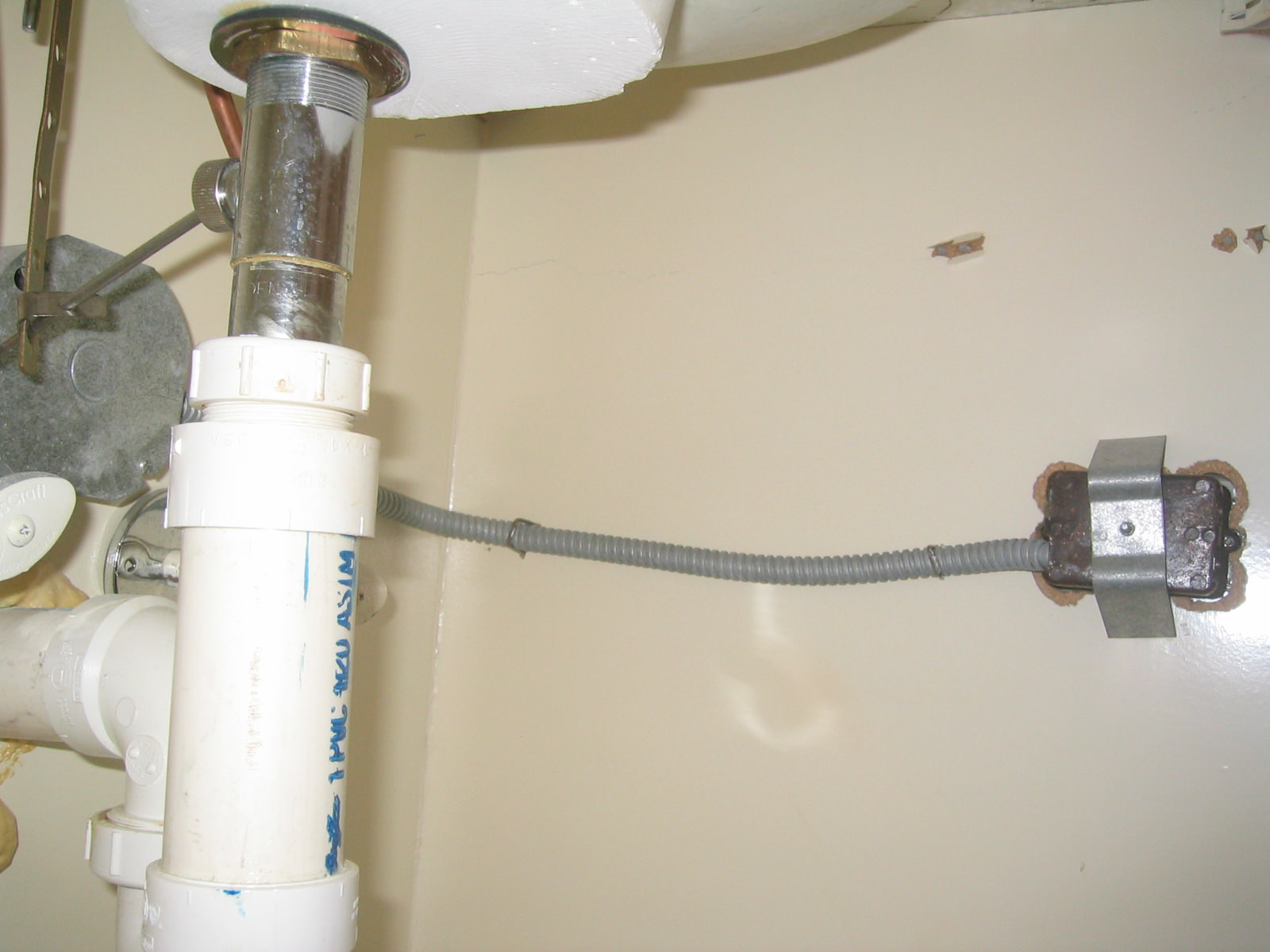

BlackJack Posted November 10, 2005 Report Share Posted November 10, 2005 Bathroom outlets under under vanity cabinet. Any problem with this? Not exactly on a wall but it is within 3 feet. House built in 1995. No other outlets on this wall or near the sinks. All are GFCI. Download Attachment: 2005-11-09 18-07-38.jpg 395.66 KB Download Attachment: 2005-11-09 18-07-44.jpg 352.67 KB Quote Link to comment Share on other sites More sharing options...
inspectort Posted November 10, 2005 Report Share Posted November 10, 2005 Jack, Article 210.52D exception allows you to mount the recepticle no more than 12" below the basin on the cabinet. If the recepticle that is shown just below the basin is GFCI protected I think that meets the intent of the code. T. Quote Link to comment Share on other sites More sharing options...
BlackJack Posted November 10, 2005 Author Report Share Posted November 10, 2005 It is, Thanks Quote Link to comment Share on other sites More sharing options...
paul burrell Posted November 11, 2005 Report Share Posted November 11, 2005 Originally posted by BlackJack Bathroom outlets under under vanity cabinet. Any problem with this? Not exactly on a wall but it is within 3 feet. House built in 1995. No other outlets on this wall or near the sinks. All are GFCI. Download Attachment: 2005-11-09 18-07-38.jpg 395.66 KB Download Attachment: 2005-11-09 18-07-44.jpg 352.67 KB Looks to me that a knockout is open at top left of junction box. If I am not mistaken no unsued knockouts that are open are allowed. Paul B. Quote Link to comment Share on other sites More sharing options...
