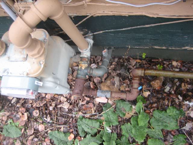

4000sposse Posted April 20, 2015 Report Share Posted April 20, 2015 This CSST piping is installed outside, albeit for only a couple of inches until it enters the house through an old exhaust. From what I have read this pipe can not be installed on the exterior. And cannot not go through an exterior wall? Click to Enlarge 56.22 KB Also, it appears that gas lines have been added or modified. Does anyone off hand know if these shut off valves are OK? I don't know of anything wrong with having valves like this outside, but something doesn't seem right. The gas appliances all have correct shut offs. Click to Enlarge 69.66 KB Thanks, Eric Quote Link to comment Share on other sites More sharing options...
inspector57 Posted April 20, 2015 Report Share Posted April 20, 2015 You need to check the manufacturers installation instructions but I have never seen a prohibition on installing CSST outside, nor on those valves. I would recommend rodent proofing the entry point. Quote Link to comment Share on other sites More sharing options...
Bill Kibbel Posted April 20, 2015 Report Share Posted April 20, 2015 The major CSST manufacturers have had their tubing tested and approved for outdoor installation. However, it needs protection from physical damage when installed on a building from grade to 6'. I have heard that a couple municipalities might have their own rules prohibiting CSST on the exterior. Quote Link to comment Share on other sites More sharing options...
Brandon Whitmore Posted April 21, 2015 Report Share Posted April 21, 2015 I don't see any issues with the CSST installation; I'm not aware of any manufacturer's prohibiting its use outdoors. The most common defect I see on exterior installations is missing yellow jacket material @ the nut; any of the exposed steel must be wrapped with an approved tape. The valves appear to be typical ball valves, and should be fine. The pipe must be at least 3.5" above grade-- I can't tell from the picture if the required clearances have been met. Utilities have their own bypass requirements, so I won't comment from a utility standpoint on this one. The gas fitter was no expert, but this seems to be more of the rule than the exception these days. If it isn't leaking....... Quote Link to comment Share on other sites More sharing options...
Brandon Whitmore Posted April 21, 2015 Report Share Posted April 21, 2015 Eric, The next time you have a CSST installation question, you should look at the name of the manufacturer on the pipe, and then pull up the installation manual on-line. Quote Link to comment Share on other sites More sharing options...
4000sposse Posted April 21, 2015 Author Report Share Posted April 21, 2015 Thanks. A tech from the gas company got back to me this morning and he told me it OK to run CSST outside as long as its protected as needed, and OK to have it enter the building. Quote Link to comment Share on other sites More sharing options...
