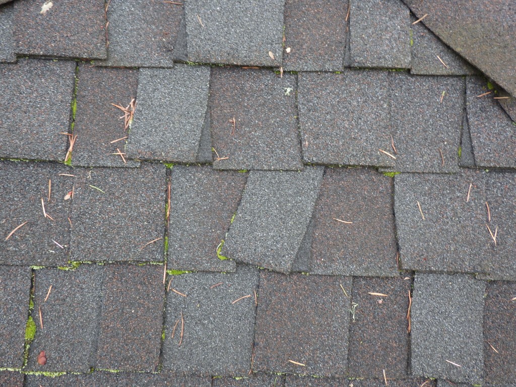

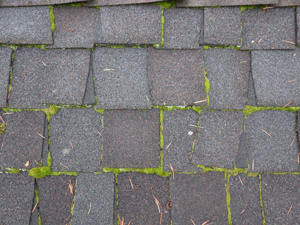

Jim Katen Posted January 28, 2021 Report Share Posted January 28, 2021 6-year old roof. I don't recognize this brand or model of shingle. Lots of the upper lamination tabs were twisted. While it looks goofy, I doubt that it'll have any effect on the roof's performance. Has anyone else seen this? Any idea what caused it? Is this some new look that the kids like these days? Quote Link to comment Share on other sites More sharing options...
Tom Raymond Posted January 28, 2021 Report Share Posted January 28, 2021 Maybe they're seconds. Quote Link to comment Share on other sites More sharing options...
Jim Katen Posted January 29, 2021 Author Report Share Posted January 29, 2021 Or thirds. Quote Link to comment Share on other sites More sharing options...
hausdok Posted February 15, 2021 Report Share Posted February 15, 2021 I think the roof was probably installed on a very hot day and as people walked around on the roof some of the tabs moved and then re-bonded after the sun went down. Quote Link to comment Share on other sites More sharing options...
Jim Katen Posted February 16, 2021 Author Report Share Posted February 16, 2021 That's exactly what it looks like. But I've walked on a lot of hot roofs and never had tabs do that when I was walking on them. Maybe the crew was getting down to Chubby Checker or something. 1 Quote Link to comment Share on other sites More sharing options...
