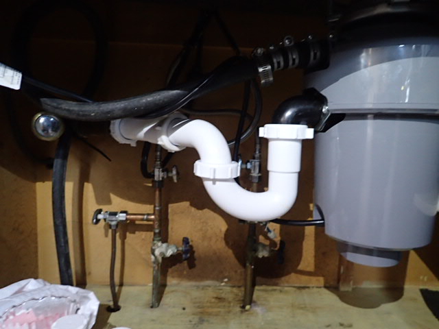

greyboy39 Posted February 10, 2021 Report Share Posted February 10, 2021 Would this be considered a running trap and or is there any problem with this configuration? The trap arm is plenty long and has proper pitch although is does not look it in the photos. Quote Link to comment Share on other sites More sharing options...
Jim Katen Posted February 10, 2021 Report Share Posted February 10, 2021 That's a regular P trap. A running trap wouldn't be serving a single fixture, it would be a trap in the middle of a long run of pipe, without any particular relationship to a specific fixture. A whole-house trap is a running trap. Quote Link to comment Share on other sites More sharing options...
greyboy39 Posted February 10, 2021 Author Report Share Posted February 10, 2021 Gotcha, just thought the minimal tail piece may have prohibited the configuration. Thanks Jim Quote Link to comment Share on other sites More sharing options...
