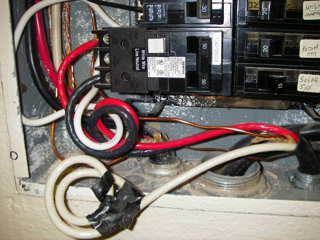

homnspector Posted March 9, 2006 Report Share Posted March 9, 2006 This hot tub was wired by an electrician. I can't figure out why the grounding conductor was not hooked up in the panel. Download Attachment: IMGP3901.JPG 154.76 KB 220 volt GFCI breaker, wiring in conduit to the 220 V spa J box. Equipment ground connected in the panel but the neutral not connected. Link to comment Share on other sites More sharing options...
Brian G Posted March 9, 2006 Report Share Posted March 9, 2006 There is no neutral on 220v circuits. He just used a cable that had one more conductor than he needed, for whatever reason. Brian G. Is Switzerland Really Neutral, Or Are They Actually a Grounding Conductor?! Film at 11. [] Link to comment Share on other sites More sharing options...
