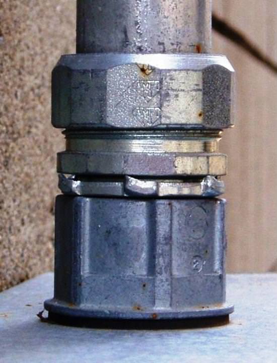

Joe Tedesco Posted May 31, 2007 Report Share Posted May 31, 2007 312.2(A): For enclosures installed in wet locations, revised to require any cable or raceway that enters on the top or on the side above the level of uninsulated live parts in the enclosure be provided with fittings listed for wet locations. Download Attachment: locknut.jpg 60.38 KB Quote Link to comment Share on other sites More sharing options...

Joe Tedesco Posted May 31, 2007 Author Report Share Posted May 31, 2007 Originally posted by ozofprev Thanks Joe. I can see where the lock-nut might allow for water intrusion, but how can the HI know that the lock-nut, combined with a particular grommet (for example) is not allowed? IOW, can we assume that every lock-nut is a violation of the rules? A locknut installed on the top of any enclosure in a wet location would not be permitted. All fittings that are used must be listed for wet locations. http://www.nema.org/stds/fb2-10.cfm#download Quote Link to comment Share on other sites More sharing options...

Joe Tedesco Posted May 31, 2007 Author Report Share Posted May 31, 2007 Your picture shows a "Meyers Hub" and it is the same type of fitting that is used in the picture I posted above. Ordinary locknuts are not designed to be used in wet locations. http://www.foxelectricsupply.com/conten ... ryId=25003 http://www.foxelectricsupply.com/conten ... ryId=25005 Quote Link to comment Share on other sites More sharing options...
PAbernathy Posted May 31, 2007 Report Share Posted May 31, 2007 Hey Joe..good to see you.....( sorry about the book thing..I got side tracked ) I think what joe is saying is the locknut itself is ok...the connector itself needs to be listed for wet locations. What compounds the issue is like in the first picture joe posted they used a locknut outside and before the actual waterproof connector..so the connector screwed into it just before it is not rated for wet locations at all....compounding the problem... The entire connector needs to be rated for a wet location....would you agree Joe? I think what it is trying to stop is the " what ever I have in the truck" mentality..... Quote Link to comment Share on other sites More sharing options...

Joe Tedesco Posted May 31, 2007 Author Report Share Posted May 31, 2007 Originally posted by PAbernathy Hey Joe..good to see you.....( sorry about the book thing..I got side tracked ) I think what joe is saying is the locknut itself is ok...the connector itself needs to be listed for wet locations. What compounds the issue is like in the first picture joe posted they used a locknut outside and before the actual waterproof connector..so the connector screwed into it just before it is not rated for wet locations at all....compounding the problem... The entire connector needs to be rated for a wet location....would you agree Joe? I think what it is trying to stop is the " what ever I have in the truck" mentality..... Yes I agree Paul: The identification of electrical materials, and using correct terms is often what confuses people. We need to develop an extensive pictorial list showing proper and improper uses of fittings. The "Watertight Hubs" that were called "locknut's" here are what may be the problem. I extracted the first page and the information, although showing "HazLoc" equipment does not call this fitting a locknut. I have some more pictures showing the use of a fitting that was not designed for use in a wet location, trouble is I have so many of them it may take me a while. I am in the middle of building my new 2008 NEC Show using a new machine with Vista, so far so good, better be! I need programs that will work. I will have a backup XP machine with me just in case. What do you mean here: "sorry about the book thing..I got side tracked" Download Attachment: fitting.pdf 141.61 KB Quote Link to comment Share on other sites More sharing options...

Joe Tedesco Posted May 31, 2007 Author Report Share Posted May 31, 2007 Gary: My original image showed the "upside down locknut" I was identifying and your comments took the discussion toward a special type of fitting and yes the "locknut" is as you described and as you stated. The issue is that the ordinary simple locknut we use on threaded connections is not permitted to be used at the top of the entry into an outdoor enclosure where it would not provide a weather tight or "rain tight" termination, and the inside of the enclosure would have a locknut, or a locknut and bushing. Think of it this way, the open knockout in the top of any box out of doors is never to be used with anything other that a listed fitting designed for that use. Quote Link to comment Share on other sites More sharing options...

Frankie Boy Posted June 2, 2007 Report Share Posted June 2, 2007 In the picture it looks like a Meyers hub with typical Nema 1 locknut between the hub and a rigid threadless connector. If the conduit entering the hub is theaded,then it is not protected from moisture hence the word {threadless},but we don't know that the conduit is threaded or not. Now we have the problem of a Nema 1 locknut, this should have been a sealing locknut, if any at all. It has been my experience that if there is a hole water will find it. Frank Quote Link to comment Share on other sites More sharing options...
