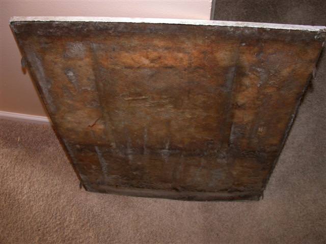

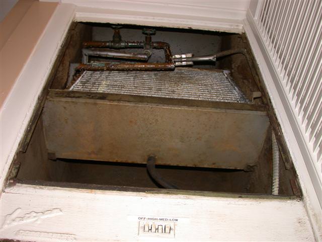

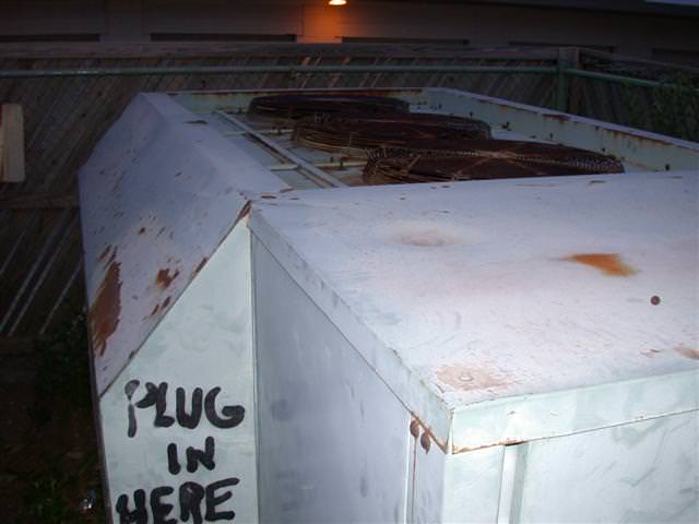

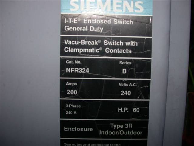

chicago Posted July 4, 2007 Report Share Posted July 4, 2007 Building built in 1963 and I am guessing this is original.Condo conversion four years ago. Main unit is outside in a corral with 3 fans and I am not able to get info on this brand name. Looks like Knitzan or knitgan?panel Any info would really help.No plates were seen outside other than the main shutoff to the unit.Inside the living unit had a blower in the bottom section and kept the place cool.I am guessing this is some kind of chiller unit of which I am starved for info. Image Insert: 31.1 KB Image Insert: 39.81 KB Image Insert: 35.72 KB Image Insert: 52.28 KB Image Insert: 47.96 KB Quote Link to comment Share on other sites More sharing options...

Terence McCann Posted July 5, 2007 Report Share Posted July 5, 2007 Originally posted by chicago Nothing under that name either,although any info on even what type of unit this is would help. Both pipes in the pic are cold . Image Insert: 74.43 KB What you have there is a chiller. Both lines are cold because there is chilled water running through the pipes, not Freon. You have the normal condenser, compressor and then a chiller barrel in which water flows on one side and Freon is on the other. You then have a circ pump that takes the chilled water and pumps it to the HVAC unit(s). These units typically have a slab evaporator that the chilled water flows through. The control for these evaps can sometimes be a 3-way mixing valve that is thermostatically controlled. They like to use 3-way mixing valves to keep a constant head on the pump so that it doesn't cavitate. The inside unit is known as a fan-coil unit. Simply stated it's a fan with a water coil. I would imagine that the unit is used for both heating and cooling so I would think there is a boiler present too. The fan-coil units typically have a strap-on thermostat that is attached to the supply water line to the water coil. When the thermostat senses hot water it changes the room thermostat to direct operation for heat and when it senses chilled water is changes the operation to reverse acting. What Kurt said is spot on - it's long in the tooth and will need replacement soon. The original manufacture is not important. IMO, Trane screw chillers are the best that can be purchased. The slant-six of chillers. Quote Link to comment Share on other sites More sharing options...

Dion B Posted April 23, 2009 Report Share Posted April 23, 2009 Im a Engineer of a building in chicago ive been working on these units for over six years now. They are Kritzer combinex units the combinex means it can run heated or chilled water through the 2 pipe system. The kritzer fan coil unit runs using a 1/6 hp motor controled by an inducer (looks like a transformer) this controls the speed to the motor it was made by carson which no longer manufactures these anymore. part #2576 stamped on it. Also the strap on thermostat is actually more like change over switch this is what is used to go from Heat to cooling. This part if made is impossiable to find so i tested out a few over the years the the part i use is a TAC Erie Thermostatic Change over Switch part #680-243-x your white wire goes to your switch L1 of kritzer unit,black wire is for Heat and, Blue is for Cool to wall t-stat. If you have problems with the motor on the fan coil unit i recommened using a Fasco D-158 3-speed motor and abandoning the inducer/transformer. If you have any other questions please feel free to ask. Quote Link to comment Share on other sites More sharing options...
