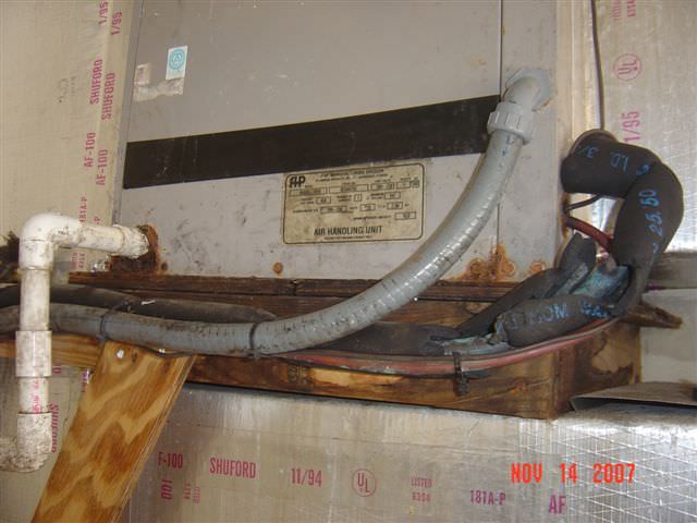

tbowker Posted November 19, 2007 Report Share Posted November 19, 2007 Just came across an air handler manufactured by FHP manufacturing: M#: HE023-1AHX S#: BC066783. Anyone have any idea when it was manufactured? Here is a pic of the label: Image Insert: 54.78 KB Quote Link to comment Share on other sites More sharing options...
Jim Katen Posted November 19, 2007 Report Share Posted November 19, 2007 Originally posted by tbowker Just came across an air handler manufactured by FHP manufacturing: M#: HE023-1AHX S#: BC066783. Anyone have any idea when it was manufactured? Florida Heat Pump uses the first letter of the serial number for the year. B is either 1972 or 1995. I'd guess 1995. The Shuford tape say 95 or 94 in at least three places and would seem to back up an install date of '95. - Jim Katen, Oregon Quote Link to comment Share on other sites More sharing options...
