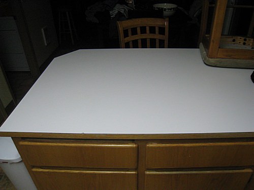

Chris Bernhardt Posted February 1, 2008 Report Share Posted February 1, 2008 This experiment demonstrates the need to scan for moisture with a moisture meter and why an IR camera shouldn't be used as a decision point. Image Insert: 86.94 KB My kitchen counter top dry at the start of the experiment. Image Insert: 34.11 KB What the thermal camera saw at the start of the experiment. Image Insert: 33.71 KB The film of water left by swiping a damp sponge across the counter. Image Insert: 86.97 KB I laid a piece of plastic wrap over the film of water and measured it with my moisture meter then let it normalize with the ambient air for an hour. Image Insert: 33.9 KB After an hour this is what the IR camera saw and my moisture meter was still reading the same. Chris, Oregon Quote Link to comment Share on other sites More sharing options...

Chris Bernhardt Posted February 1, 2008 Author Report Share Posted February 1, 2008 Yesterday I went back to a mfg. home to do a reinspect and brought along the IR camera. I was particularly interested in looking at a floor and wall adjacent to an exterior door that was showing a definite pattern of moisture intrusion when I scanned it with the Tramex, but when I looked at the same area with the IR camera it didn't show anything. My theory is that unless there has been substantial moisture intrusion to the point that the thermal conductance of the wall, ceiling or floor that you are looking at has been affected and assuming a decent thermal gradient across them, the IR camera isn't going to pick anything up. Also if the surfaces have an effective vapor barrier like paint or a vinyl floor covering then you're not going to pick up differences due to evaporation. I had already performed some similar experiments with my moisture meter that demonstrated that my Tramex can't tell the difference between a thin film of moisture or a saturated substrate. I will bring you more demonstrations soon. Chris, Oregon Quote Link to comment Share on other sites More sharing options...
