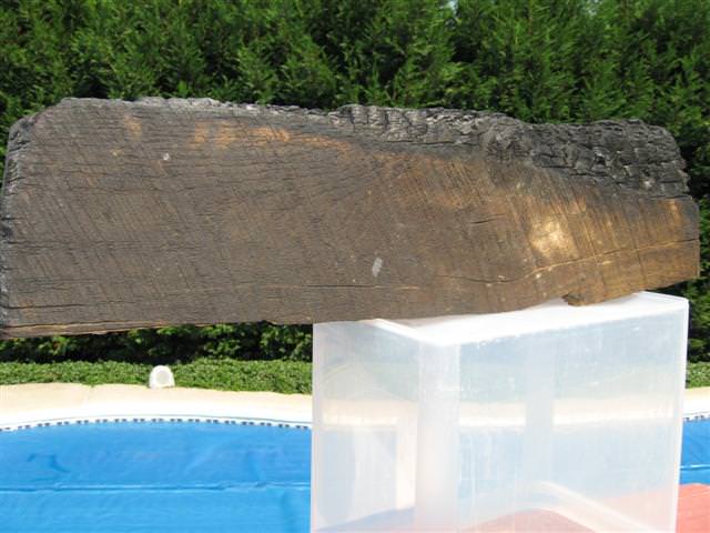

Inspectorjoe Posted August 17, 2008 Report Share Posted August 17, 2008 I'm not sure where to post this, so I put it here since I saw it at the exterior. What is this? I did a Google image search for bait boxes and came up with things that looked kind of similar, but not really all that close. There was only one, located at a corner, a few inches from the foundation. The house was an 8 year old ranch. Image Insert: 141.04 KB Image Insert: 197.45 KB Quote Link to comment Share on other sites More sharing options...
gtblum Posted August 17, 2008 Report Share Posted August 17, 2008 Were you able to pull the whole thing up for a look? Quote Link to comment Share on other sites More sharing options...
Inspectorjoe Posted August 17, 2008 Author Report Share Posted August 17, 2008 Since I didn't know what it was, I sure as heck wasn't going to try to pull it out of the ground. Quote Link to comment Share on other sites More sharing options...
Scottpat Posted August 17, 2008 Report Share Posted August 17, 2008 Looks like an old termite "cocaine" station! I really have a problem attracting termites to a bait. If they are not properly maintained those crack hungry little buggers will search out for the Grand 2x4 Buffet! Quote Link to comment Share on other sites More sharing options...
hausdok Posted August 17, 2008 Report Share Posted August 17, 2008 Hi, I wouldn't have a problem using a bait station to knock out a subterranean termite nest. Subs aren't getting their "fix" at a station, they're getting killed. It's the workers that have to bring food back to the nest for the queen and her drones. If you knock off the workers the nest dies of starvation - that's how the bait stations work. The stations are initially baited with wood to attract the workers. Once the workers know where the food source is, they let everyone know and pretty soon all workers are going to that one station to forage; that's when you replace the wood with termiticide. Next thing you know, all the workers are toast and the queen, drones, and larvae are dried up and worm food. ONE TEAM - ONE FIGHT!!! Mike Quote Link to comment Share on other sites More sharing options...
ghentjr Posted August 17, 2008 Report Share Posted August 17, 2008 That is a termite bait station. I may have held wood, or active bait, but I can't tell from the picture. The bait system works quite well, once you get the workers to start feeding on the bait. Quote Link to comment Share on other sites More sharing options...
Bill Kibbel Posted August 17, 2008 Report Share Posted August 17, 2008 Hey Joe, It's a B&G termite bait station. Quote Link to comment Share on other sites More sharing options...

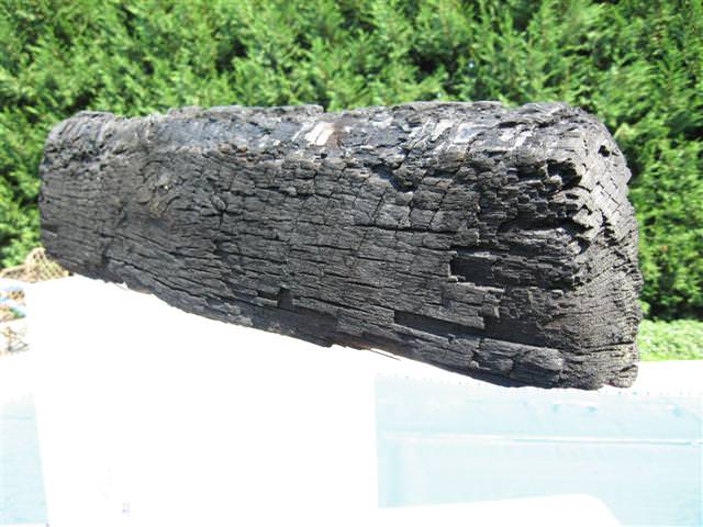

Inspectorjoe Posted August 18, 2008 Author Report Share Posted August 18, 2008 So it is a bait station. I kind of thought so, but it was odd having only one, at a relatively new house, in the middle of what used to be a field. Holy cow Bill, is there anything you can't identify - not to mention come up with a picture too? Here's another one. See if you can identify this structural member from my collection. I'll bet you have no trouble. It's from a Town lattice truss. The structure it came from had been listed on the National Register of Historic Places. It was removed June 27, 1986. The piece became available for my acquisition on a sad January night in 1985. Image Insert: 67.27 KB Image Insert: 69.86 KB Image Insert: 56.67 KB Quote Link to comment Share on other sites More sharing options...
Bill Kibbel Posted August 18, 2008 Report Share Posted August 18, 2008 Holy cow Bill, is there anything you can't identify - not to mention come up with a picture too? Here's another one. See if you can identify this structural member from my collection. I'll bet you have no trouble. A Town lattice truss is very typical of many local covered bridges. That timber is from the Haupts Mill covered bridge. Next question. Quote Link to comment Share on other sites More sharing options...
