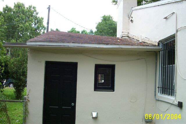

Danny Pritchard Posted June 1, 2004 Report Share Posted June 1, 2004 60+ year old home.Sellers disclosure statement according to the buyers agent did not mention anything about the roof.I wonder what non problem the sellers thought they were fixing after spreading about 2 gallons of roof cement along the edge of this roof. Download Attachment: Sloped roof0003.jpg 71.79 KB Link to comment Share on other sites More sharing options...
Rob Amaral Posted June 4, 2004 Report Share Posted June 4, 2004 Danny-did that room have a 'cathedral' ceiling by the way? Nice sag at the ridge there... Just wondering. Link to comment Share on other sites More sharing options...
Danny Pritchard Posted June 4, 2004 Author Report Share Posted June 4, 2004 Rob, That room was the garage built with rafters.It had collar ties near the top of the ridge.It looked like the rafters were once tied between the top plates from the front to the rear walls.These were removed when the room was converted to living space and a new high ceiling was installed. Link to comment Share on other sites More sharing options...
