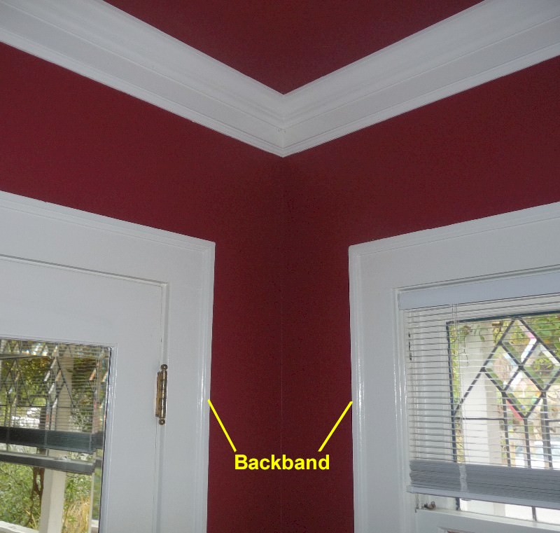

kurt Posted December 6, 2008 Report Posted December 6, 2008 Jamb extensions are not complicated or hard to install. Use 1/2" drywall, and rip appropriate sized extensions, installe them w/ 1/4" reveal, and then retrim the windows. It'll add a little time, but it will look right.
Richard Moore Posted December 6, 2008 Report Posted December 6, 2008 Originally posted by kurt Jamb extensions are not complicated or hard to install. Use 1/2" drywall, and rip appropriate sized extensions (out of wood, not the drywall), installe them w/ 1/4" reveal, and then retrim the windows. It'll add a little time, but it will look right. I'm with Kurt there as far as using 1/2" drywall, extensions, and adding reveals. Stepping the extensions and trim (1/8" to 1/4") will give the windows and doors more "interest" and you won't be trying to fill and sand to achieve a flush look. It's what I'd do. Unfortunately, if you do that, the original side and top trim pieces will now be too short. But...if you don't mind buying a few new pieces of 1-by, then no problem. Hell...add some brick molding (actually "backband") for an even better look. Image Insert: 125.7 KB
