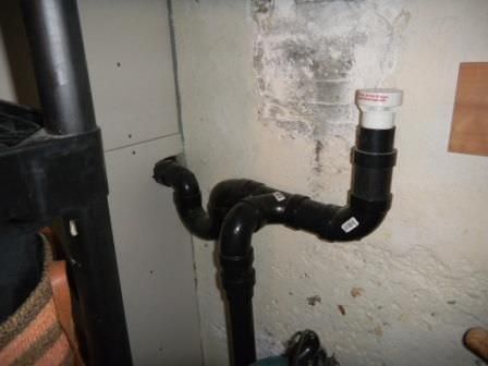

Jeff Beck Posted March 4, 2009 Report Share Posted March 4, 2009 I'm starting to doubt myself here. 1999 house that's a good 20" above curb height. Sellers told my client that the house flooded once several years ago and that they would replace what they believed to be an undersized sump pump. When I inspected the house the sump is plumbed with two 2" PVC pipes to the exterior. The one that's connected to the sump pump drains to what appears to be the footing drains (larger pipe on the left). When the pump is activated the water is pumped out of the sump and immediately drains back in again. It's possible that there is some type of underground drain system that is damaged and leaking back into the footings but I can't determine that without digging up the drain. Plus the speed with which the water returns is so fast, that if the drain is damaged it must be really whacked. Does anyone know of a reason to connect the output of a sump pump to the footing drains? (Besides spending more on electricity, pump replacement and the noise of a sump pump going bad?[:-bigeyes Sorry that the picture isn't better, the other pic that I took didn't turn out. Jeff Beck Foresight Inspection Service LLC Click to Enlarge 69.2 KB Quote Link to comment Share on other sites More sharing options...
Jim Katen Posted March 4, 2009 Report Share Posted March 4, 2009 . . . When I inspected the house the sump is plumbed with two 2" PVC pipes to the exterior. I don't understand. A sump pump has a single outlet connection. How can it be connected to two pipes? The one that's connected to the sump pump drains to what appears to be the footing drains (larger pipe on the left). When the pump is activated the water is pumped out of the sump and immediately drains back in again. It's possible that there is some type of underground drain system that is damaged and leaking back into the footings but I can't determine that without digging up the drain. Plus the speed with which the water returns is so fast, that if the drain is damaged it must be really whacked. Does anyone know of a reason to connect the output of a sump pump to the footing drains? No. There's no good reason to do that. Around here, we plumb the sump pump discharge into the rain drain system. If there isn't one, you could run the discharge pipe underground to the street curb, a dry well, the low side of the lot or even a dozen or so feet out into the yard, terminating in a bubbler. Quote Link to comment Share on other sites More sharing options...
hausdok Posted March 4, 2009 Report Share Posted March 4, 2009 I'll bet it's a masceration pump that's being used as a sump pump. One pipe is the vent and the other is the outlet. It sure sounds like you've got a broken receiver drain. Anything that comes off the roof, plus what you pump into it is going to return to the basement. Eventually, you'll undermine the danged drain by removing so much soil around it that it will get worse. Or, it might be that they didn't bother to install a check valve on it and what's left in the line simply washes back into the sump well again. They need to have a drainage guy check the pump to ensure water isn't draining back into it from the line because there is no check valve and install one if necessary (You should have seen it); if there is a check valve, he'll need to dig up the drain to check it and ensure it's not broken below grade and make repairs if necessary. ONE TEAM - ONE FIGHT!!! Mike Quote Link to comment Share on other sites More sharing options...
Jeff Beck Posted March 5, 2009 Author Report Share Posted March 5, 2009 Sorry Jim, I didn't make myself clear[:-paperba We sometimes see two pipes in a sump here, one for the main pump and another one for a battery back-up pump in case of a power failure. This sump pump is only connected to one pipe, the one that appears to go to the footings. The other pipe is the one that I would have expected the pump to have been connected to. That one should have an extension added to carry the moisture away from the building. The thing that throws me is that the installation looks pretty professional. If it were a happy homeowner job I would have expected some cobbled up piping. Mike, It is definitely a sump pump with a mercury float and not a maceration pump. Thanks for the fast follow-up! Jeff Quote Link to comment Share on other sites More sharing options...
