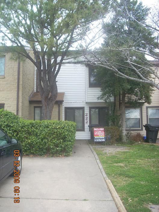

This is the house BTW,,,,
Click to Enlarge
99.75Â KB
Another BTW, yes I did look through out the house for other signs such as wall/ceiling cracks but found none. BUT! The whole interior of the house was painted about 2 weeks ago. So if there were any cracks, I wouldn't be seeing them.
