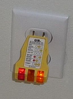

Richard Moore Posted June 25, 2009 Report Share Posted June 25, 2009 This has been bugging me a bit since Monday. New townhouse. Besides the gas fireplace switches being left buried behind the drywall, I had a single duplex receptacle in the middle of a living room wall that showed Hot/Ground reversed on my 3-light tester. I then used a multi-meter and found that both the ground and the hot gave me 120 volts to the neutral. Because of the hot ground, I didn't feel like taking the cover plate off and just reported it as in need of prompt repair. However, how would that happen??? None of the other receptacles had any issues so it couldn't simply be the grounding wire in contact with the hot terminal (which, in any case, should have tripped the breaker). I'm left with a horribly bad (even evil) receptacle itself, or some wing-nut who wing-nutted the ground wire pigtail with the hots. Any other options? Just curious in Seattle. Quote Link to comment Share on other sites More sharing options...

Richard Moore Posted June 25, 2009 Author Report Share Posted June 25, 2009 Wouldn't reversed polarity explain it? If so, what you thought was the neutral was really hot. Hi Jim, I've used this same tester many times and it has a different light pattern for reverse polarity (hot/neutral reversed). I think they all do. I've seen that many times. This is the first time I can remember ever seeing the hot/ground reversed pattern. Here, I even took a photo... Click to Enlarge 14.61 KB So...yes, you are right that reversed polarity would give me the same readings I got with the multi-tester. But then why would the three-light tester read hot/ground reversed in the first place and not just the normal reversed polarity? I know these things can't diagnose multiple problems but I would expect the same readings for the same condition. BTW...I didn't want to fry my Suretest so I didn't try that. Damn...now you got me wishing I had thrown the breaker, taken the cover off and done a bit more 'vestigating. Oh well. I stuck a large piece a large piece of tape over the receptacle with "hot ground" written on it. Something is wrong. The builder's electrician can sort it out. Quote Link to comment Share on other sites More sharing options...

hmiller Posted June 26, 2009 Report Share Posted June 26, 2009 My guess would be a loose neutral wire... It is not likely that the ground is really hot. Rather what happens is that your tester is being tricked... Notice that the "open ground" light uses the far left light only. And the "Hot/ ground reverse" uses left and right lamps. My guess is the neutral has a poor connection but is not fully disconnected, energizing the far right lamp on the tester. Quote Link to comment Share on other sites More sharing options...

Richard Moore Posted June 26, 2009 Author Report Share Posted June 26, 2009 You'll get the two outside lights to light up if you connect the same hot wire to both the neutral and hot screws on the receptacle. But, I had 120v between hot and neutral. Thanks for trying though, Jim. I've moved on, but will pick up one of those cheap neon testers for future use in the test you described earlier. I'll sue you if it zaps me! [] Quote Link to comment Share on other sites More sharing options...
