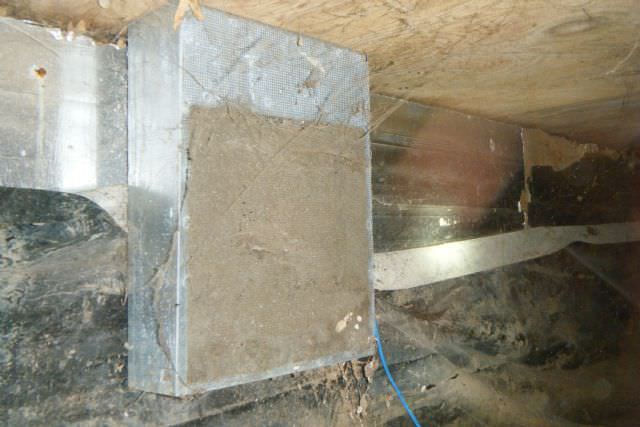

Brandon Whitmore Posted July 15, 2009 Report Share Posted July 15, 2009 I had an interesting job this morning, that I could use some input on. The crawlspace was a plenum crawlspace that had 6mil black plastic with dusty pea gravel installed on top. The registers were still in place, but the screens on the duct boots? that extended into the crawlspace were mostly plugged with debris/ dust. The original heating system was replaced with a heat pump with an air handler in the attic. New ductwork was installed, with ceiling registers were installed for this new system. As soon as I walked into the home, I could smell a musty odor. First thing I did once I realized I was not inspecting a slab, was open the crawlspace hatch-- whew........ There was a very slight whitish substance on the subfloor and framing--- probably fungal matter, but I can not be sure as it was pretty light. The exposed metal at plumbing hangers and nails that penetrated the subfloor were pretty rusty. There is obviously a moisture / humidity issue in the crawlspace, possibly due to the fact that the crawlspace no longer has air flowing through it. To make matters worse, the only toilet drain was leaking heavily under the home, so there was a 5 square foot area that was moist with waste water--- yuck. I know that this leak had something to do with the smell, but do not believe that this is the only cause of the humidity issue in the crawlspace. Since the crawlspace is no longer acting as an HVAC plenum, I think that the crawlspace should either be vented to the exterior, or a de- humidifier type system (http://www.basementsystems.com/crawlspa ... difier.php) should be installed. What do you all think? I recommended that they replace the pea gravel and contaminated vapor barrier. I told them they should talk to an indoor air quality expert to see what their options are for the crawlspace, etc. Quote Link to comment Share on other sites More sharing options...

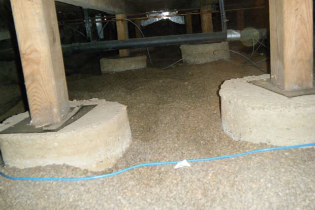

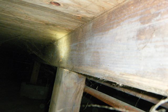

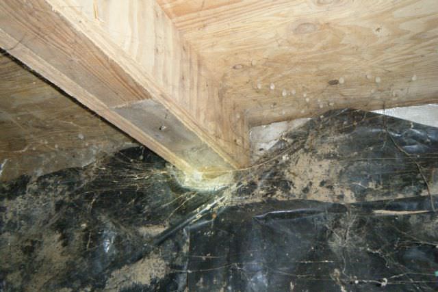

Brandon Whitmore Posted July 16, 2009 Author Report Share Posted July 16, 2009 Here's some pictures of the crawlspace. Click to Enlarge 45.86 KB Click to Enlarge 49.28 KB Click to Enlarge 36.75 KB Click to Enlarge 47.32 KB Click to Enlarge 56.45 KB Quote Link to comment Share on other sites More sharing options...
hausdok Posted July 16, 2009 Report Share Posted July 16, 2009 Hi, What you don't know is if there's a drain under that pea gravel. A sealed crawlspace like that needs a drain or it becomes a swimming pool liner filled with gravel and whatever else drains into that gravel. I'd recommend that they fix the leak, use a long piece of rebar to punch that barrier material in a few dozen places, install a drain to the outside, put down another barrier on top of that pea gravel and seal it to the barrier material at the walls, make sure the plastic at the walls is sealed to the walls but doesn't extend up over the top of the foundation, and then connect the drain to the barrier. Once that's done, clear the mesh so that the air in there can be conditioned and things can dry out, and then treat all of that wood with a fungicide (BoraCare or TimBor) to make sure that the fungi is knocked back. What's up with the repair scabbed onto the end of that beam? Did they fail to isolate the end of the beams from the concrete and it came under attack? ONE TEAM - ONE FIGHT!!! Mike Quote Link to comment Share on other sites More sharing options...
Brandon Whitmore Posted July 16, 2009 Author Report Share Posted July 16, 2009 What's up with the repair scabbed onto the end of that beam? Did they fail to isolate the end of the beams from the concrete and it came under attack? About 8 beams were like this. It looks like they did not have long enough beams.. You probably can't tell from the picture I posted (I've got others), but the plywood that is sandwiching the beam is the original T&G subfloor material, so I'm fairly positive this was done when the place was built. Very odd, but there is no evidence of movement. Quote Link to comment Share on other sites More sharing options...
