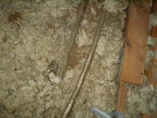

tnpappas Posted July 23, 2009 Report Share Posted July 23, 2009 At least half of the outlets are open ground 3-slot outlets. This pictures below are of the wiring in the attic. What is this wiring called? Looking for wording about the danger of open ground 3-slot outlets. Should these outlets be protected by a GFCI breaker or outlet, and labled no ground? Click to Enlarge 54.67 KB Click to Enlarge 54.11 KB Quote Link to comment Share on other sites More sharing options...
Brandon Whitmore Posted July 23, 2009 Report Share Posted July 23, 2009 The wiring is cloth sheathed Romex. Open grounded 3 prong receptacles either need to be properly grounded, GFCI protected, or replaced with 2 prong receptacles. Quote Link to comment Share on other sites More sharing options...
MTL_Inspet_Man Posted July 24, 2009 Report Share Posted July 24, 2009 Looks like cloth sheathed Romex Typical in older homes. This hose may originally have had 2 prong outlets. They may have been swappped for more modern 3 prongs. They may have bonede the outlets using the ground wire to the electrical box but there probably is no real ground to speak of. Did u pull any outlets and take a pic? Quote Link to comment Share on other sites More sharing options...
