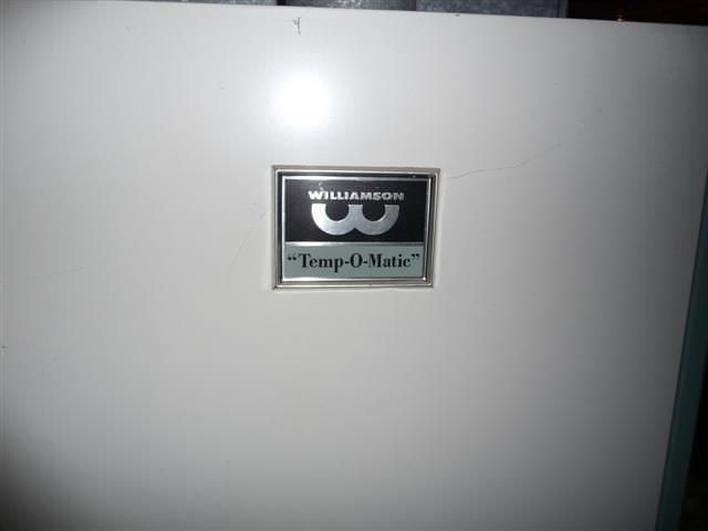

Wayne Gardner Posted January 22, 2010 Report Share Posted January 22, 2010 Hi Gary, I can look up a model number for you but that looks like a serial number? If it is a model number, I didn't see any Williamson model numbers like it in my book. Wayne G Link to comment Share on other sites More sharing options...
gtblum Posted January 22, 2010 Author Report Share Posted January 22, 2010 Hi Gary, I can look up a model number for you but that looks like a serial number? If it is a model number, I didn't see any Williamson model numbers like it in my book. Wayne G Thanks for looking. Oh. Sorry. Yup, it's the serial. Link to comment Share on other sites More sharing options...

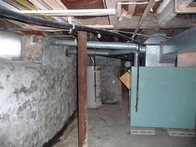

Wayne Gardner Posted January 22, 2010 Report Share Posted January 22, 2010 Without a model number, I'm just guessing...but here goes... Does it look like a 30 year old furnace? Standing pilot, natural draft, etc? Sometimes I look for the ansi date on the plate. If it is really old, I'd guess 1978. Got a picture? Wayne G Link to comment Share on other sites More sharing options...
hausdok Posted January 22, 2010 Report Share Posted January 22, 2010 Hi, Anything with "oMatic" in it, I'm going to guess is late 40's to mid 60's. Did you open the air handler to see if there was a year date on the air handler? Lots of those old furnaces have the date stamped on the blower drum. OT - OF!!! M. Link to comment Share on other sites More sharing options...
gtblum Posted January 22, 2010 Author Report Share Posted January 22, 2010 Here's what I have. Appreciate the effort. Wish I knew I'd needed more. Click to Enlarge 50.52 KB Click to Enlarge 16.71 KB Click to Enlarge 37.8 KB Shit. I just remembered the owners manual. See it on the long shot? Link to comment Share on other sites More sharing options...
johnmcq Posted January 22, 2010 Report Share Posted January 22, 2010 Preston's Guide, which goes by model numbers, lists various Williamson 1114-07-* models from 1968 to 1981. I can't make out the last digit of the model # in your pic, which would narrow it down. The serial makes me think '78. Link to comment Share on other sites More sharing options...
Wayne Gardner Posted January 22, 2010 Report Share Posted January 22, 2010 Your model number 1114-07-6 (Looks like a 6 or an 8 and there is no 8 in the Preston's Guide. So that model was manufactured in 78, 79, and 80. Serial number would confirm it is a 78 model. An old furnace, anyway you slice it. Wayne G Link to comment Share on other sites More sharing options...
