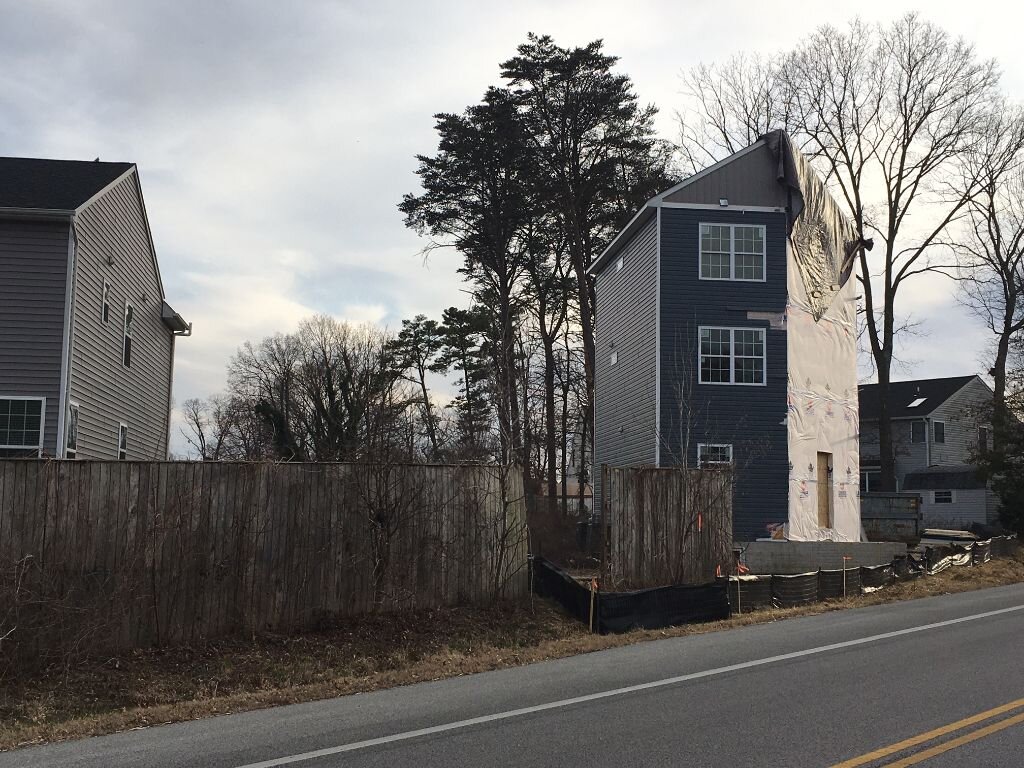

They finished buttoning up the siding. It’s weird when you approach it in a car because the angles make it look like the entire house is leaning over when compared to the house next door. It almost makes you dizzy.
