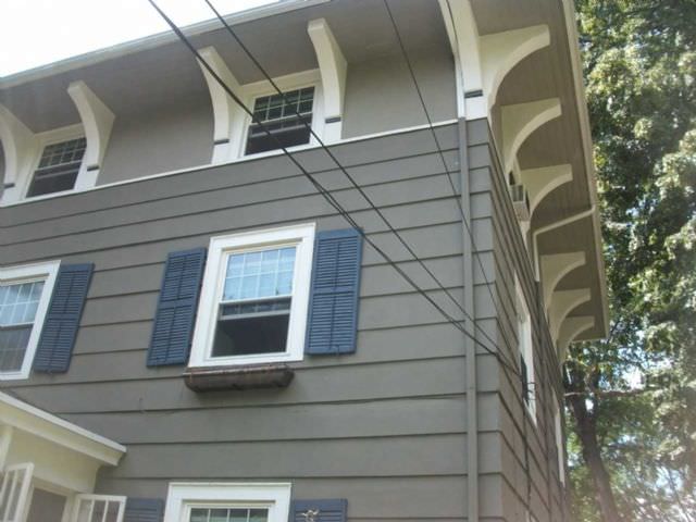

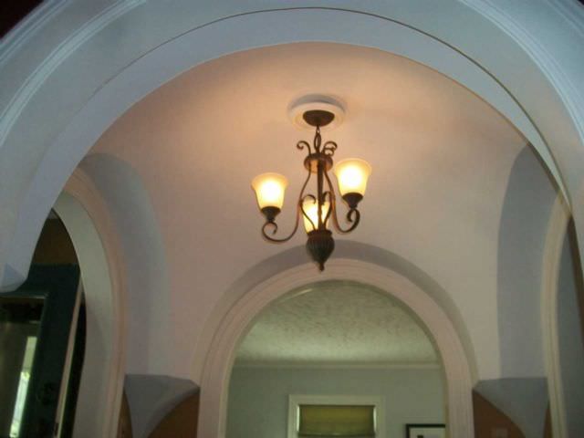

Neal Lewis Posted August 16, 2010 Report Share Posted August 16, 2010 This 1920's house has stucco siding that looks exactly like clapboard from a distance. The foyer has four arched doorways and a domed ceiling in the middle. Download Attachment: Maplewood.jpg 104.72 KB Download Attachment: Maplewood2.jpg 42.21 KB Quote Link to comment Share on other sites More sharing options...
hausdok Posted August 16, 2010 Report Share Posted August 16, 2010 Hi Neal, Are you sure it was stucco? The reason I ask is that I don't see any accessory joints or termination beads anywhere there; and every once in a while I run into a house here that's got wood claps that have been top-coated with a stucco-like cementitious coating that looks so much like stucco that it can fool you. ONE TEAM - ONE FIGHT!!! Mike Quote Link to comment Share on other sites More sharing options...
Neal Lewis Posted August 16, 2010 Author Report Share Posted August 16, 2010 There was a broken section down at the lowest course. it was cementitious through and through. I've never seen anything like it before. The brackets at the overhang were also stucco. Quote Link to comment Share on other sites More sharing options...
