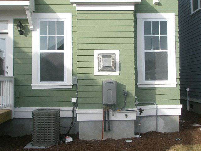

palmettoinspect Posted November 30, 2010 Report Share Posted November 30, 2010 Is it okay to install this tankless water heater directly below the for a fireplace? The direct vent is three feet from the regulator in the picture but not by much and 2 ½ from the window. I couldnââ¬â¢t find anything about installing the water heater below or that close to the direct vent just doesnââ¬â¢t seem right. Any thoughts are appreciated. Kiel Click to Enlarge 62.32 KB Link to comment Share on other sites More sharing options...
Richard Moore Posted November 30, 2010 Report Share Posted November 30, 2010 Check out http://www.rinnai.us/documentation/down ... _EN_FR.pdf , page 28. US installs require 12" clearance to "the combustion air inlet to any other appliance" (30" in Canada). I'd say you have that there, if only just. The other way around, so to speak...because the hot fireplace exhaust gas will rise, it shouldn't affect the water heater combustion air. Link to comment Share on other sites More sharing options...

palmettoinspect Posted November 30, 2010 Author Report Share Posted November 30, 2010 Check out http://www.rinnai.us/documentation/down ... _EN_FR.pdf , page 28. US installs require 12" clearance to "the combustion air inlet to any other appliance" (30" in Canada). I'd say you have that there, if only just. The other way around, so to speak...because the hot fireplace exhaust gas will rise, it shouldn't affect the water heater combustion air. Thanks! Yeah I think they might just make the 12". Kiel Link to comment Share on other sites More sharing options...
