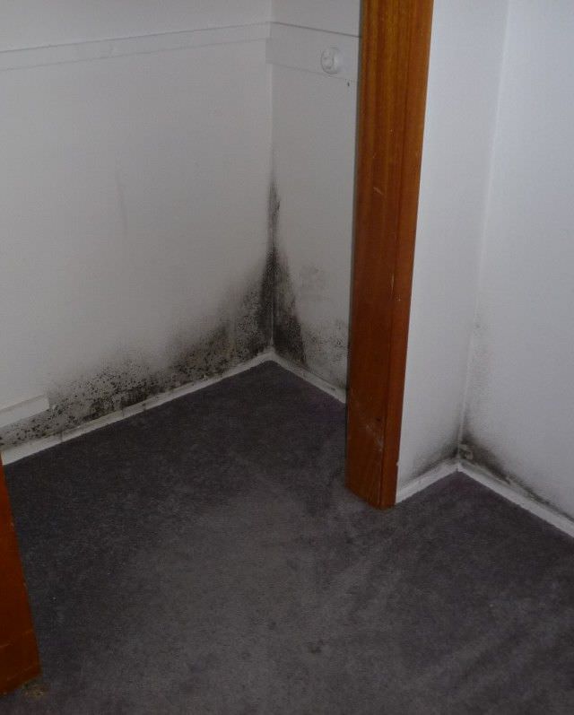

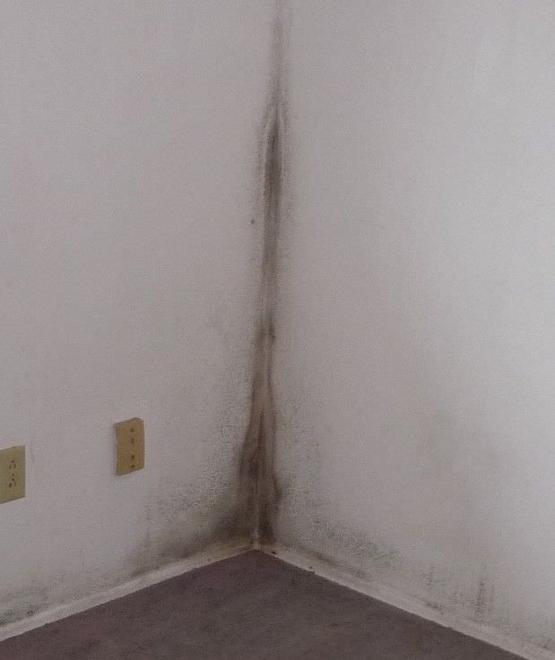

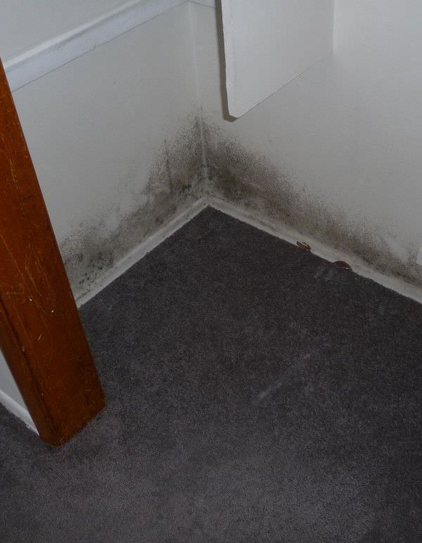

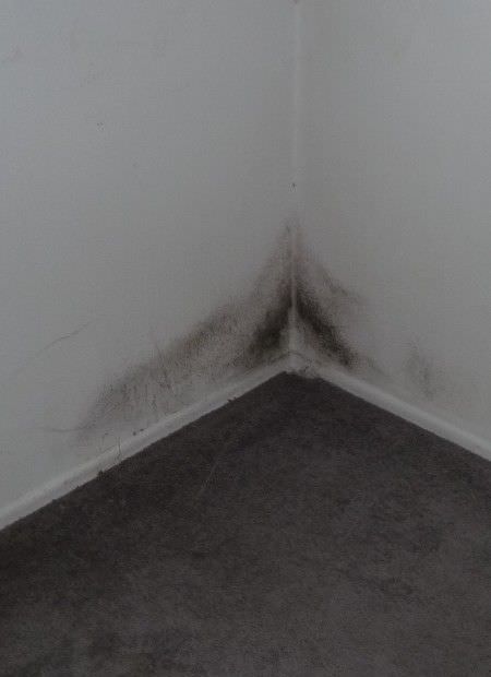

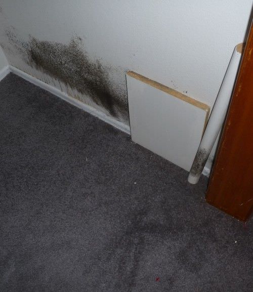

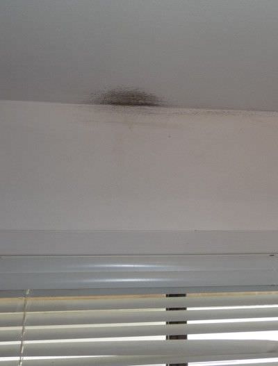

Richard Moore Posted May 6, 2011 Report Share Posted May 6, 2011 I guess I can count myself lucky that I donââ¬â¢t get to see mold like this very often. Click to Enlarge 46.93 KB Click to Enlarge 50.18 KB Click to Enlarge 17.33 KB Click to Enlarge 64.87 KB Click to Enlarge 26.21 KB Click to Enlarge 50.01 KB This was a 1962 duplex. Side by side (front and back) 2br/1ba bungalow units with shared attic and crawl. Baseboard heat only. One unit was occupied and was in very clean condition. The other was newly vacant (with the last 2-weeks according to the client) and was a mess-o-mold. I donââ¬â¢t know any more about the previous tenants. The heaviest mold was mostly at the corners and closets of the two bedrooms (some exterior walls, some interior). Some also at window surrounds and one area at the ceiling/wall juncture. There were a few lighter patches in the living room and kitchen. None of these gave any unusual moisture meter readings, all were dry. In fact, the place didnââ¬â¢t even smell that musty. Stuff that might be related(?)â⬦ Both unitsââ¬â¢ bathroom exhaust fans were not connected to the exterior and were actually buried in added loose-fill insulation. Both unitsââ¬â¢ kitchen range hoods had ducts that terminated above the attic insulation, but were also venting into the attic. Attic ventilation was good (high) to adequate (low) and no signs of any moisture problems or mold on the exposed lumber or decking, despite the stuff mentioned above. Crawl moisture barrier coverage was probably 95%. Dryer ducting of both units ran through the crawl to exterior dampers. There was a lot of lint under the dryer area, but it looked like newer repairs had addressed that. Oh...and under-floor ââ¬Åinsulationâ⬠Link to comment Share on other sites More sharing options...

John Kogel Posted May 6, 2011 Report Share Posted May 6, 2011 Yes, peeing in the corner can cause mold to grow there, but isn't it usually a kind of green algae? At least that's what I remember seeing out behind the shed. [] Lack of heat and poor air circulation would be my guess. The moisture levels are probably close to equal in the two units, but the old lady keeps her heat on and the dry electric heat keeps her walls from getting damp. Someone could write a book - a study of air quality comparisons in duplex housing. Link to comment Share on other sites More sharing options...
Brandon Whitmore Posted May 6, 2011 Report Share Posted May 6, 2011 Had a client from a few years ago call me to help figure out the mold problem in their house. Come to find out that money is tight, so 5 family members are sleeping in one bedroom, and turning the heat off in the rest of the house. The mold issue was only in that bedroom............ Some may be interested in this: Mold Link to comment Share on other sites More sharing options...
hoosier inspector Posted May 7, 2011 Report Share Posted May 7, 2011 Do you have any info on the previous resident? They could have had dirty damp laundry piled against the wall. Stored items, fish tanks, humidifiers, etc. The walls would have dried out in a short time after all the stuff was carted off. The board in the last picture does not have any mold on it, was it the result of some kind of repair, or access panel? Link to comment Share on other sites More sharing options...
Jim Baird Posted May 7, 2011 Report Share Posted May 7, 2011 Unvented gas space heaters can put a lot of water in the air. So can kerosene heaters. Link to comment Share on other sites More sharing options...
