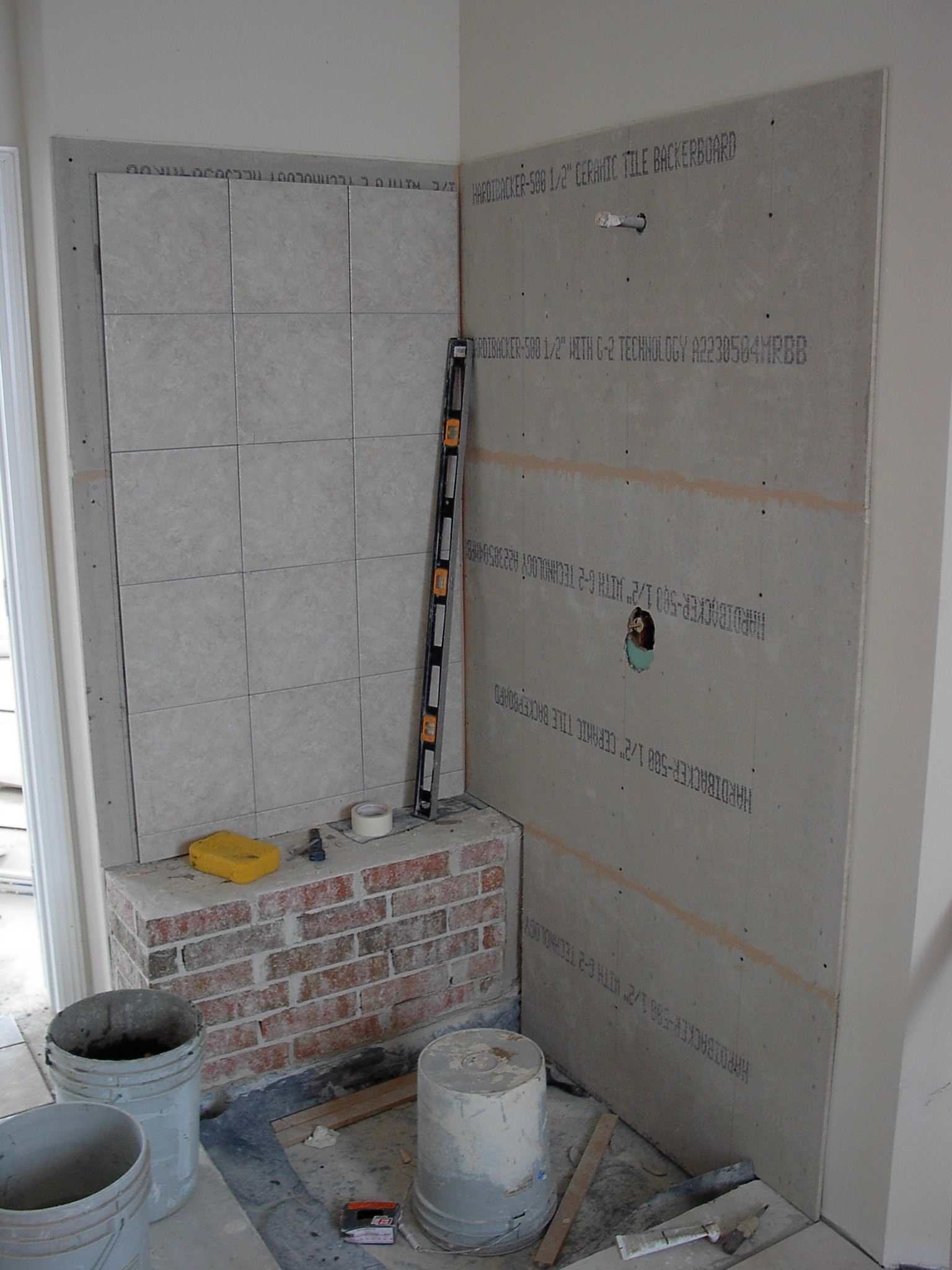

DonTx Posted March 15, 2005 Report Share Posted March 15, 2005 I did a final inspection on a home yesterday and noted high moisture levels on top of, around and below the shower seat. The client had taken of 4600 pics during construction and said he'd look up the pictures of the seat. This is what he sent me and he asked if water got below the tile and onto the seat, if it would be a problem. My reply was: There's probably a wood structure below the brick (he confirmed it was) and that the brick is not water proof. I also told him I have concerns that the right of the seat side is not sealed at the Hardi backer, but that the Hardi backer is cut out for the seat. This seat looks like it's tied into the wall structure and water could end up there due to the lack of sealing the seat at the backer. His reply was "What can be done about it?" "The only thing I know is to redo it and put a liner up over the seat this time or live with it this way" I told him What are your thoughts? Personally, I've never seen a seat constructed out of brick and I'm assuming they did it this way because they felt the brick was "waterproof". I guess I should have recommended weep holes for the brick. Download Attachment: showerstall.JPG 19 KB Super Sized Version Download Attachment: showerstall2.JPG 490.18 KB Quote Link to comment Share on other sites More sharing options...
Chad Fabry Posted March 15, 2005 Report Share Posted March 15, 2005 No moisture barrier behind the cement board, if there's wood in the seat the pan should be flashed. It's all going to get wet walls and all. Quote Link to comment Share on other sites More sharing options...
Chad Fabry Posted March 15, 2005 Report Share Posted March 15, 2005 and another thing...that brick is going to be very hard to keep clean. Quote Link to comment Share on other sites More sharing options...
kurt Posted March 15, 2005 Report Share Posted March 15, 2005 What Chad said... That baby is gonna be a nasty mess in about 18 months. Any tile or shower questions you have, air 'em out over @ the John Bridge forum; it's awesome good for tile questions. http://www.johnbridge.com/vbulletin/index.php? This is what we get when folks watch HGTV & think they know how to do stuff. Quote Link to comment Share on other sites More sharing options...
DonTx Posted March 16, 2005 Author Report Share Posted March 16, 2005 I guess I should have stated this earlier, but they tiled over the brick. It looks like your every day run of the mill tiled shower. They just used that brick work as a backer. Quote Link to comment Share on other sites More sharing options...
