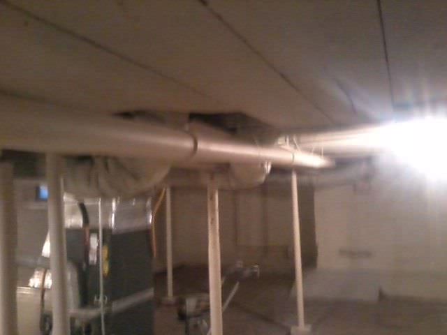

plummen Posted December 25, 2011 Report Share Posted December 25, 2011 Another house somebody spent a ton of money on that I have to redo somebody elses work on! [:-yuck] Cant find pictures ,Ill be back! [:-weepn] Download Attachment: Photo689.jpg 40.49 KB Quote Link to comment Share on other sites More sharing options...

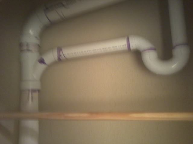

plummen Posted December 25, 2011 Author Report Share Posted December 25, 2011 Click to Enlarge 26.27?KBThats a rubber san-tee tied in with a bunch of other bootlegged crap,not a vent to be had on any of the fixtures. S-traps on all fixtures .......[:-censore That stubby little 14" stand pipe coming off the back side is for the washing machine,bottem of it is about 48" off the ground! [:-bigmout Quote Link to comment Share on other sites More sharing options...
plummen Posted December 25, 2011 Author Report Share Posted December 25, 2011 Click to Enlarge 27.02?KBThat 4" san-tee flopped on its back is going to toilet [:-censore Quote Link to comment Share on other sites More sharing options...

emalernee Posted December 25, 2011 Report Share Posted December 25, 2011 Yea, but everything is painted up real nice! Quote Link to comment Share on other sites More sharing options...
plummen Posted December 25, 2011 Author Report Share Posted December 25, 2011 Yeah thats what threw me for a loop at first on the rubber san-tee,I thought it was a melted piece of pvc at first! [:-paperba Quote Link to comment Share on other sites More sharing options...
