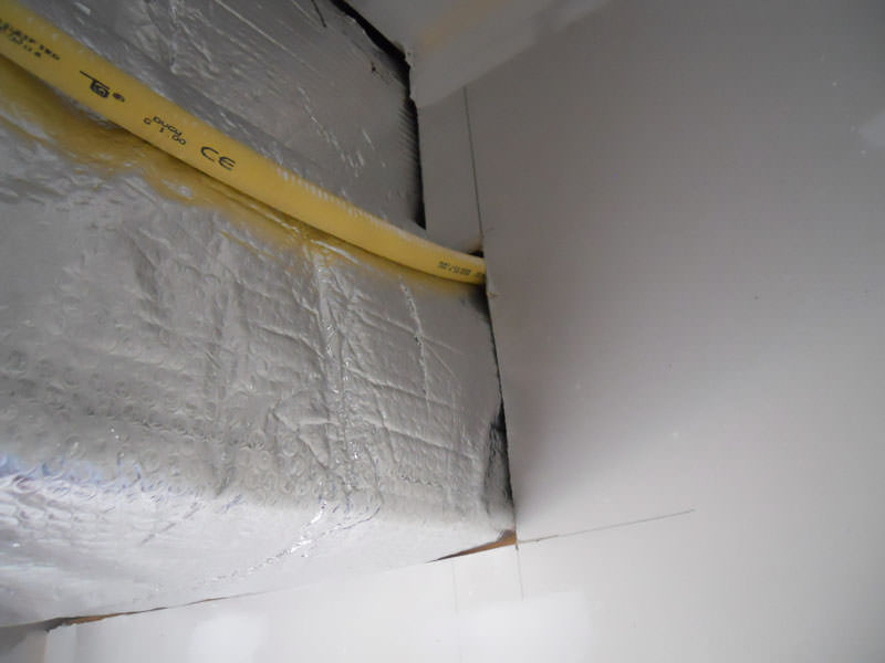

rbaake Posted February 14, 2012 Report Share Posted February 14, 2012 Searched but did not find anything. Can CSST pass through walls as in this installation? I seem to recall the need for a protective plate? Thanks in advance! Download Attachment: Photo 017.jpg 66.05 KB Link to comment Share on other sites More sharing options...
Robert Jones Posted February 14, 2012 Report Share Posted February 14, 2012 This is what I have always understood to be the norm; All points of penetration less than 2 inches (50.8mm) from any edge of a stud, joist, plate etc., a striker plate is required to provide protection at the area of support and within 5 inches (127mm) of each side (if appropriate) of the support. At points of penetration 2 to 3 inches (50.8 to 76.2mm) from any edge of a stud, joist, plate, etc., a striker plate is required to provide protection throughout the area of support. At points of penetration greater than 3 inches (76.2mm) from any edge of a stud, joist, plate etc., no protection is required. Tubing routed horizontally through studs shall be protected from puncture threats between the studs using shielding devices provided. Link to comment Share on other sites More sharing options...
