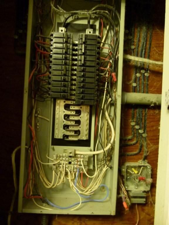

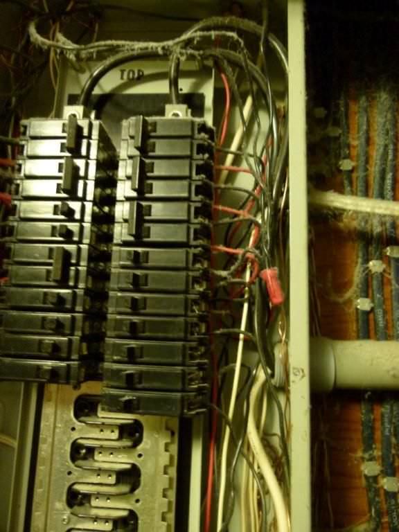

John Kogel Posted July 18, 2012 Report Share Posted July 18, 2012 I can't be sure because of the picture quality, but I think I see solid Aluminum branch circuits. Are the bare ground wires silver? Solid Aluminum branch circuits should be inspected and serviced in their entirety by a qualified electrician every 10 years to avoid loose or scorched connections. Google the subject for more info. A home inspector would have told you this and it could have been made a condition of the sale. If that isn't Al, ignore the above. [] I think I see a couple of double-taps, lower left? Those can be repaired by adding jumpers, but only if the circuits are not overloaded by doing so. Best to have a couple of new breakers installed. The open junction box has a doorbell transformer attached. Wiring for the doorbell was allowed to be double-tapped in '76, and the extra draw is minimal, so that one is probably alright. I question a red wire going to the neutral bus. Not saying it is wrong, but it can lead to miswiring at the other end. Both ends should be marked as neutrals with a piece of white tape. Link to comment Share on other sites More sharing options...

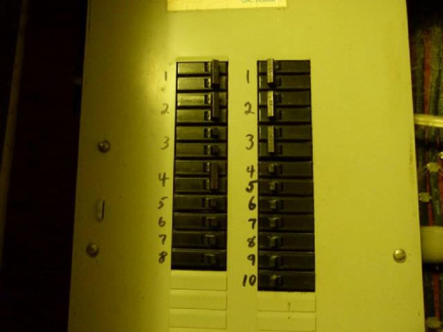

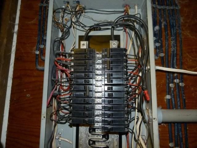

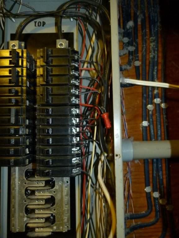

Tembo Posted July 18, 2012 Author Report Share Posted July 18, 2012 Thank you again Marc and John. I'm sure everything is strictly copper; no sign of Al anywhere. Just took a few more pics, this time with flash; please see attached. Honestly I'm not comfortable touching this board other than to look. Partly this is because my hands nowadays are not too steady (I'm 71 and just finished a bunch of radiation treatment). Ironically as a "kid" I thought nothing of working on "hot" 220v circuits back in the UK. It looks like I'm in for a date with an electrician. They're few and far between here in Elliot Lake. A neighbour just paid $500 to have a new single dedicated 15a outlet installed on a new breaker direct from the board. Is this normal? (I don't know how much "fishing" was involved). Again, thank you very much Marc and John! Click to Enlarge 52.7 KB Click to Enlarge 76.63 KB Click to Enlarge 76.88 KB Click to Enlarge 62.02 KB Click to Enlarge 32.17 KB Link to comment Share on other sites More sharing options...
John Kogel Posted July 18, 2012 Report Share Posted July 18, 2012 OK, I see copper, that's good. There's a kinky wire in the upper left that looks like Al, but again that could be an illusion. I see you have 3 240 15 amp circuits on the upper right, electric heat? Well with the heat off, you should easily have enough juice there to run an air conditioner. Have you tried plugging the PC into another circuit? Try to trace the circuit to see what's up with it. The more info you can provide the electrician, the easier it will be for him to estimate the repair. You need an electrician without a doubt, because the symptoms you describe aren't normal. But I don't see a total disaster there, just judging from these pics. And as Roger Whittaker would say, "Baby, the rain must fall". [] Link to comment Share on other sites More sharing options...
