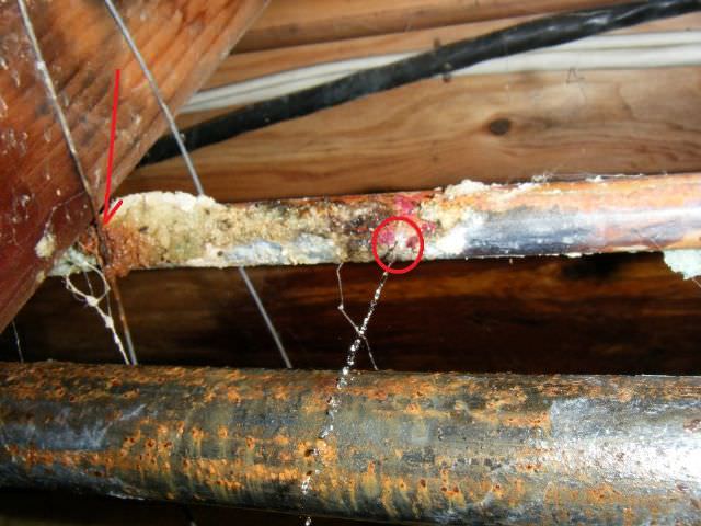

Denray Posted August 31, 2012 Author Report Share Posted August 31, 2012 So the 30# laps every half sheet. It laps over the tub rim too? The Durock laps the tub rim? Or just butt it all to the top of the tub and the tile laps the rim. The admix is what exactly? Something that makes it waterproof? If I had used whole tiles instead of the tiny ones and new what the heck backer rod was way back when we did it and never had the bright idea of using grout as the tub/wall sealer the thing would still be working. So my wife hears a dripping noise through the P-trap opening while we are monkeying with this, goes under the house, finds a hot water leak that has been going on for 3 weeks at least turning every sq inch of insulation into a rain forest. Sheesh. Click to Enlarge 62.04?KB Click to Enlarge 41.21?KB Link to comment Share on other sites More sharing options...

Scottpat Posted September 1, 2012 Report Share Posted September 1, 2012 Denny, you need a can of that spray on rubber sealant to seal that pipe! Ya' know the stuff that the guy sprays the screen door on the bottom of the boat and then puts it in the water! [] Link to comment Share on other sites More sharing options...
Denray Posted September 1, 2012 Author Report Share Posted September 1, 2012 Beat you to it Scott. We sprayed the whole area right away with 17 cans of that goo in order to keep the water off the dirt below. It's all sealed up nice and tight now. Link to comment Share on other sites More sharing options...
