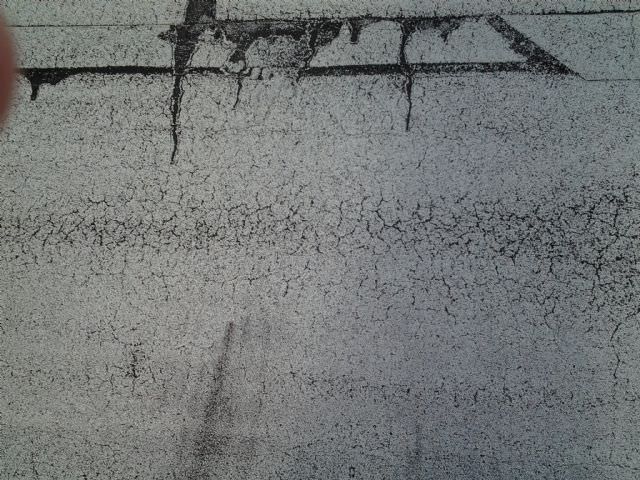

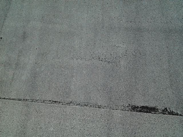

kurt Posted December 6, 2012 Report Share Posted December 6, 2012 My first take is the roofing company is attempting to trade on mythology. Alligatoring rarely means anything bad; it means someone slopped on too much tar. 9 years is barely a 1/3 of the way through the "normal" life of a mod bit roof in Chicago. Florida sun will cook stuff quickly, but 9 years should still have some life in it. Put up some pictures if possible. Quote Link to comment Share on other sites More sharing options...

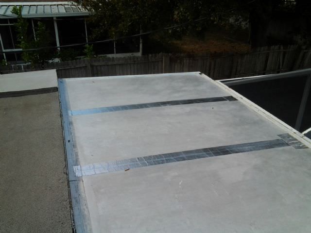

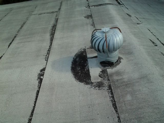

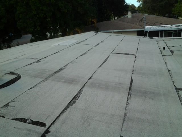

omagic12 Posted December 8, 2012 Author Report Share Posted December 8, 2012 Sorry for the delay. Pics attached. Recent eves repair was done using Polyglass polyfex peel and stick modbit cap sheet over(asphalt) primed existing roof with old roof cut back 18 inches from edge. In the process of applying peel and seal to seams on insulated aluminum patio roof. I will also apply 12" peel and seal where the flat roof adjoins the aluminum patio roof. Plan to attach it to flat deck's drip edge facing and cover seams and old peel and seal on aluminum patio roof to form an L-shape avoiding any gaps. Click to Enlarge 94.79 KB Click to Enlarge 65.02 KB Click to Enlarge 54.04 KB Click to Enlarge 41.54 KB Click to Enlarge 53.49 KB Click to Enlarge 37.78 KB Click to Enlarge 36.47 KB Click to Enlarge 55.53 KB Click to Enlarge 67.19 KB Click to Enlarge 98.96 KB Quote Link to comment Share on other sites More sharing options...
Marc Posted December 8, 2012 Report Share Posted December 8, 2012 Ditch the ABC Roofing Supply rep. The gatoring looks too small to be an issue, unless there's active leaks. Marc Quote Link to comment Share on other sites More sharing options...
kurt Posted December 8, 2012 Report Share Posted December 8, 2012 I'd put that in the basic half-assed install with the usual inadequacies. It'll work OK for some number of years. I can imagine reflective coatings helping a lot; they work. Yes, I know the naysayers, give them some props, but my experience tells me UV inhibiting coatings work, and common sense says silver reflective coatings have to be better than black. Reflective coatings would work here in all the little cracks and crazes you can't even see; UV still gets in there and breaks down the material. Yes, the granules reflect most of it, but in terms of area, there's probably some good percentage of area still exposed that doesn't have granule. It's peeling in the corners because of the flashing material. Forget aluminum gravel stops/drip edges/flashing details. Mod bit doesn't weld to aluminum worth a darn. (I'll modify that to, it'll weld sorta ok if you double prime it and go overtime on getting the welds tight, but I'd still be watching it every year.) You want minimum .032 galvanized; if you don't want shiny metal, use Keynar coated material (available in the usual brown, bronze, white colors). Double prime this stuff, and it'll hold forever. Well, almost forever. What about venting? What's the roof structure? Is there an "attic" in there? All that magic membrane that keeps the water out also keeps the water in; I have a hard time imagining a single turban vent does much, but I could be wrong. Quote Link to comment Share on other sites More sharing options...

kurt Posted December 8, 2012 Report Share Posted December 8, 2012 Personally, I'd wait 'til I did the roof. You sound like a hands on sort....check it periodically and repair if necessary. The beauty of mod bit is it's accessibility; if you know your way around a torch and trowel, you can repair it easily and forever. So, no attic. If it all looks OK, it probably is. Agreed on the punk wood sold nearly everywhere nowadays. Quote Link to comment Share on other sites More sharing options...
omagic12 Posted December 8, 2012 Author Report Share Posted December 8, 2012 I am moderately handy and leaning a lot about roofing materials and issues through great sites as this and others around the web. Trouble is lately I feel I might be over-thinking the process through to much Internet researching. I have never tried using a torch, but comfortable using cement, trowel and mod-bit roll. My son and I just finished peel and seal(ing) the aluminum patio roof, 3-coursed an area of concern and asphalt primed some of the (top) of exposed drip edge and cap sheet to ready it for adhesive cement. Probably over-kill but at this point I am settled on function vs. looks. Thanks again for your responses Kurt. Quote Link to comment Share on other sites More sharing options...
kurt Posted December 8, 2012 Report Share Posted December 8, 2012 ......I feel I might be over-thinking the process through to much Internet researching. Good observation. It's really not complicated. Go to the mfg's. sites, read up. Try to avoid DIY boards and orange aproned aisle dwellers advice, you'll do fine. Quote Link to comment Share on other sites More sharing options...
