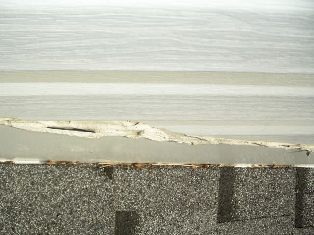

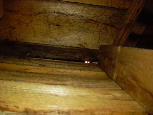

Stephen Lagueux Posted January 21, 2013 Report Share Posted January 21, 2013 A few years ago I received a call to perform a roof inspection. It was an old house and the owner had received a grant from the county to have his roof redone. So he finds a roof contractor, the guy does the job and ate through the entire $11,000 grant. A couple of months later, the owner complained of water leaking from the roof. The contractor came once to fix it and wants nothing to do with the repairs anymore. Here are a few picks after the repairs. General view of the house Click to Enlarge 44.82?KBClick to Enlarge 48.98?KB We could actually see daylight from the inside Click to Enlarge 41.45?KB Just a few of many Flashing over aluminium panels Click to Enlarge 97.29?KB Flashing over vinyl siding (the newer caulk is the roof guy's repair the second time around) Click to Enlarge 47.27?KB Click to Enlarge 58.06?KBClick to Enlarge 78.6?KBClick to Enlarge 66.42?KB I felt so bad for the owner, the kind of guy that no pennies love him, cripple from one leg and had no ressources to help him. I reffered him to a coulpe of lawyers I know. Unfortunately, this kind of thing happens too often. He was clearly taken advantage of and I told him I would testify if needed to. I havn't heard from him so far. Link to comment Share on other sites More sharing options...

Stephen Lagueux Posted January 22, 2013 Author Report Share Posted January 22, 2013 It sure could indeed. The funny thing about it is the roof guy heard of my inspection and then tried to make me look like the one who didn't know what I was doing. There was almost ground for lawsuit for defamation there. Claims can take a long time, I guess I still have time to hear from all of them. Link to comment Share on other sites More sharing options...
