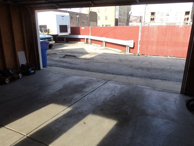

Jerry Simon Posted April 26, 2013 Report Share Posted April 26, 2013 The eye on the left side of the picture is about 6" above the garage floor. The eye on the right side is about 3' above the floor. The door opens and closes just fine, and when I interrupt either eye, the door reverses. The eyes are not slanted and pointing at each other. What am I missing here? Click to Enlarge 51.02 KB Quote Link to comment Share on other sites More sharing options...
kurt Posted April 27, 2013 Report Share Posted April 27, 2013 Nothing. The door works. Make a note to put both at 6"; it'll still work. Quote Link to comment Share on other sites More sharing options...
Richard Moore Posted April 27, 2013 Report Share Posted April 27, 2013 Jerry, the emitter and sensor don't function with a laser thin beam. The actual working angle probably varies from model to model, but within that angle, they just need line of sight. Given the distance across a double door, I'm not too surprised a set would still work without being aimed more directly. BTW, that looks a lot closer to 2' than 3'. Still wrong, but we are now just talking about 18" difference across a 12' opening. Quote Link to comment Share on other sites More sharing options...
Jerry Simon Posted April 27, 2013 Author Report Share Posted April 27, 2013 Jerry, the emitter and sensor don't function with a laser thin beam. The actual working angle probably varies from model to model, but within that angle, they just need line of sight. Given the distance across a double door, I'm not too surprised a set would still work without being aimed more directly. BTW, that looks a lot closer to 2' than 3'. Still wrong, but we are now just talking about 18" difference across a 12' opening. When I accidentally jostle my eyes when walking by/into 'em, if they're even the slightest bit out of alignment, the door won't close. That's whats throwing me off here. Quote Link to comment Share on other sites More sharing options...
