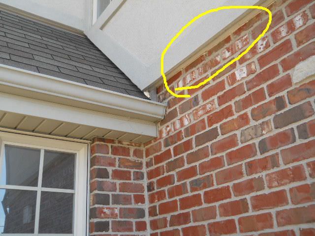

Mike Lamb Posted January 14, 2014 Report Share Posted January 14, 2014 I have looked at a couple EIFS details and did not see one for this. Is no drainage required? Click to Enlarge 68.84 KB Click to Enlarge 68.84 KB Quote Link to comment Share on other sites More sharing options...
hausdok Posted January 14, 2014 Report Share Posted January 14, 2014 required Quote Link to comment Share on other sites More sharing options...
Mike Lamb Posted January 14, 2014 Author Report Share Posted January 14, 2014 Click to Enlarge 69.15 KB Thanks. Do you have a drawing somewhere? Is it similar to this pic below? Click to Enlarge 55.6 KB Quote Link to comment Share on other sites More sharing options...
BADAIR Posted January 15, 2014 Report Share Posted January 15, 2014 wall-soffit termination is the best way to install these intersecting situations http://www.wconline.com/articles/print/ ... ll-details not sure what that daubed crown trim is about other than trying to mask a bad eifs to brick transition... it's still really bad a good eifs applicator could remove the trash & add another eifs detail Quote Link to comment Share on other sites More sharing options...

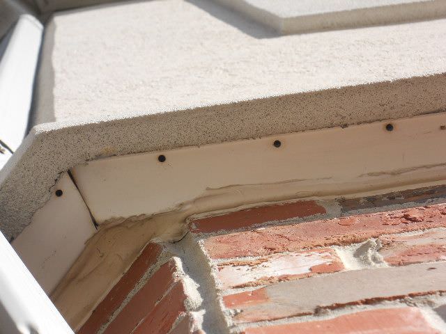

Mike Lamb Posted January 15, 2014 Author Report Share Posted January 15, 2014 wall-soffit termination is the best way to install these intersecting situations http://www.wconline.com/articles/print/ ... ll-details not sure what that daubed crown trim is about other than trying to mask a bad eifs to brick transition... it's still really bad I think that photo is playing tricks on the eyes. That is a drainage/weep detail beneath the EIFS bump-out which was one of the good things here. Click to Enlarge 39.73 KB Click to Enlarge 64.61 KB I did not see any details at the link you provided. Quote Link to comment Share on other sites More sharing options...
StevenT Posted January 16, 2014 Report Share Posted January 16, 2014 EIFS should not be installed horizontally so you may not find a detail. In the real world it exists and has to be addressed. Lets look at the whole wall as a system. Under the window it would have been nice if the (EIFS) bottom was sloped with drainage (with flashing) at the bottom. Sometimes in a horizontal situation I recommend installing vents (sometimes eaves vents) to eliminate the "closed box effect". There should be drainage (including some type of weepage and internal moisture barrier) for all the EIFS. The detail you want will be that of a transition between EIFS and a ledge. (in this case there is simply no horizontal cap on the ledge/top of brick veneer). There should be flashing (through wall) that caps the ledge and diverts water that has drained from the EIFS away from (behind) the top of the brick veneer (structure). This flashing should also slope away from the structure. There should also be drainage behind the brick veneer, including flashing (through wall) and weep holes at the system bottom and above lintels. There should be an internal moisture barrier that covers the entire substrate, which would run higher than the EIFS drainage/flashing. If appropriate, this flashing should be overlapped with an internal moisture barrier going up (behind the EIFS). I would also seal the bottoms of the flashing to prevent wind driven rain from entering, but do not seal the top of the flashing, which would impede drainage. Quote Link to comment Share on other sites More sharing options...
