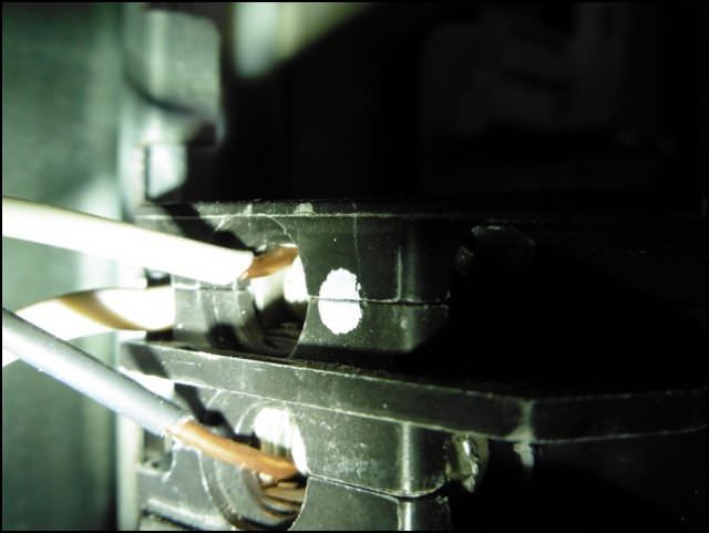

Lots of loose connections at breakers and conductors lodged at the side of the terminal screws instead of clamped underneath them.

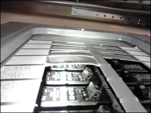

Breakers smashed under knockouts that were not removed.

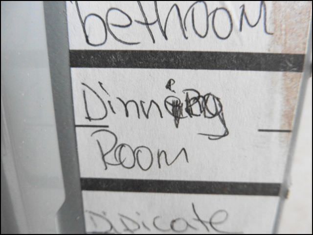

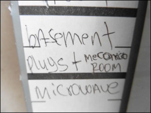

All kinds of misspelled and incorrect labeling.

And the AHJ has signed off approving the whole mess.
