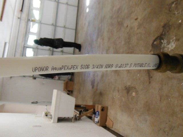

Denray Posted March 4, 2015 Report Share Posted March 4, 2015 Is this PEX OK for TPR? Click to Enlarge 21.31 KB Click to Enlarge 36.65 KB Quote Link to comment Share on other sites More sharing options...
Erby Posted March 4, 2015 Report Share Posted March 4, 2015 Yes. Quote Link to comment Share on other sites More sharing options...

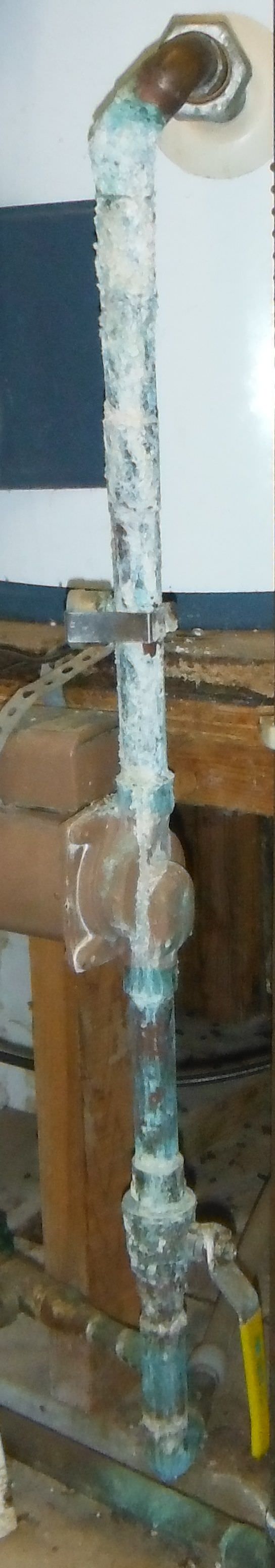

Denray Posted March 5, 2015 Author Report Share Posted March 5, 2015 Check out that discharge pipe lower down on the wh. Corroded big time. I figer it's from a steel clamp nearby doing the electrolysis thing. Thanks Erby for the reply. Quote Link to comment Share on other sites More sharing options...
Brandon Whitmore Posted March 5, 2015 Report Share Posted March 5, 2015 Not in OR it wouldn't be.... Quote Link to comment Share on other sites More sharing options...
mlparham Posted March 5, 2015 Report Share Posted March 5, 2015 Check out that discharge pipe lower down on the wh. Corroded big time. I figer it's from a steel clamp nearby doing the electrolysis thing. Thanks Erby for the reply. That's a stain on the floor. Quote Link to comment Share on other sites More sharing options...
Denray Posted March 5, 2015 Author Report Share Posted March 5, 2015 Nope Click to Enlarge 179.46 KB Quote Link to comment Share on other sites More sharing options...
Tom Raymond Posted March 5, 2015 Report Share Posted March 5, 2015 That is from a leak. Quote Link to comment Share on other sites More sharing options...
Denray Posted March 5, 2015 Author Report Share Posted March 5, 2015 Thanks Tom Quote Link to comment Share on other sites More sharing options...
mlparham Posted March 5, 2015 Report Share Posted March 5, 2015 Nope Click to Enlarge 179.46 KB That picture was not in your original post. Unless you see a leak it looks like a rookie using to much flux. Quote Link to comment Share on other sites More sharing options...
Denray Posted March 6, 2015 Author Report Share Posted March 6, 2015 It's in the first pic. No leak at that time. Quote Link to comment Share on other sites More sharing options...
mlparham Posted March 6, 2015 Report Share Posted March 6, 2015 I have never seen a water heater plumbed that way. The gas line needs a drip leg. Quote Link to comment Share on other sites More sharing options...
esch19 Posted May 7, 2015 Report Share Posted May 7, 2015 That corrosion is why after the pipes cool off from plumbing it, you wipe them with a wet rag to clean off excess flux. Quote Link to comment Share on other sites More sharing options...
