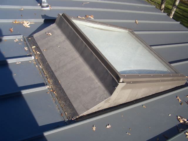

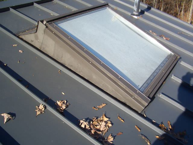

sgbroimp Posted November 30, 2015 Author Report Share Posted November 30, 2015 Here are the promised photos: Click to Enlarge 49.07 KB Click to Enlarge 40.42 KB Click to Enlarge 34.69 KB Click to Enlarge 48.2 KB Quote Link to comment Share on other sites More sharing options...
Marc Posted November 30, 2015 Report Share Posted November 30, 2015 Given what I see in those photos, skylights and standing-seam roof covers just do not seem to play well together. It's a bad marriage. Go back to shingles or remove the skylight. Marc Quote Link to comment Share on other sites More sharing options...
kurt Posted November 30, 2015 Report Share Posted November 30, 2015 Yeah, that fellow is a leaker. I'd guess it to leak just like you described.....high wind specific conditions. You're backing up a ways to make it right. Quote Link to comment Share on other sites More sharing options...
David Meiland Posted December 1, 2015 Report Share Posted December 1, 2015 He could possibly have used the Velux sloped curb, but he would have had to install it on another curb that was flashed with metal bent to order from the roofing manufacturer. As far as I can tell, the Velux item is designed to be shingled in. I wonder how that installer normally deals with skylights on metal roofs. I wish I could easily get some photos of mine, but I'm chicken-sh!t on a ladder anymore. They're on a 6:12 pitch with the eave about 18 feet above a concrete slab. I do have a ladder hook built into an adjacent part of the roof, so I could conceivably climb 20 feet up on a 12:12 pitch and then cross over onto the 6:12. Last time I was up there was in a bucket lift, which I rented to trim trees. Quote Link to comment Share on other sites More sharing options...
Tom Raymond Posted December 1, 2015 Report Share Posted December 1, 2015 No need to wonder David, I'd wager you're looking at exactly what he does. It's far too neat to be an on the fly solution. Wrong, but tidy. Quote Link to comment Share on other sites More sharing options...
kurt Posted December 1, 2015 Report Share Posted December 1, 2015 I wonder how that installer normally deals with skylights on metal roofs. My guess is he hasn't. He's thinking barrier instead of management; anytime there's a caulk joint on a skylite/metal roof installation, it's guessing and improv. I think it's salvageable, but there's a bunch of sheet metal that's gotta come off. Google "metal roof skylite flashing". There's a lot of pictures showing options, some right, some stupid, and a couple videos. There's a lot of ways to go at this, but they're all predicated on taking off sheet metal to get the underlayment, dams, and channels all working right. Quote Link to comment Share on other sites More sharing options...
sgbroimp Posted December 1, 2015 Author Report Share Posted December 1, 2015 Thanks, guys. I am curious what Kurt sees specifically to tell him this is a stinker in wind driven rain situations. For 10 years on original shingle install (old work not new) it did great, then after re-shingle if started this leaking business in big wind storms and as near as I can tell in only one spot, high left side. Now that is leak entry point not necessarily start location of course. But the fact is there is a whopping 20 lineal feet of curb to roof contact here (curb is about 4 x 6') and only one little trouble spot, so is the install really so junky??? Quote Link to comment Share on other sites More sharing options...
David Meiland Posted December 1, 2015 Report Share Posted December 1, 2015 The first thing I noticed is that the skirt is not on top of the ribs. Can't tell exactly what's going on at the head, and can't see the sides. Quote Link to comment Share on other sites More sharing options...
Tom Raymond Posted December 1, 2015 Report Share Posted December 1, 2015 There is no skirt. That is a step flash pan. Quote Link to comment Share on other sites More sharing options...
kurt Posted December 1, 2015 Report Share Posted December 1, 2015 I don't use terms like "junky". It leaks. Something is wrong in under where we can't see. Metal roof skylite installs that work usually look weird to those unfamiliar with the process. It's entirely unlike a shingle install. It should stand alone and not leak before the metal goes on. Quote Link to comment Share on other sites More sharing options...
kurt Posted December 1, 2015 Report Share Posted December 1, 2015 I'm looking for a picture of the flashing curb we fabricate for metal. Your install has a bunch of particular complications that needed a lot more attention than your guy gave it. Neat and clean, but wrong. Quote Link to comment Share on other sites More sharing options...
kurt Posted December 1, 2015 Report Share Posted December 1, 2015 Can't find it. Like Raymond said, the whole curb isn't intended for use with metal roofing. There should be an entire "U" shaped trough that fits around the head and sides with a high leg that gets counterflashed by the curb. Ideally, the trough should have a couple dams in it that deflect wind drive rain and cause water to run down the trough and out the bottom. This curb could be used, I suppose, but only if the installer had the rest of their act together and knew how to integrate it to the trough. The metal roofing should drain to the trough, essentially; trying to seal it at the head flashing (with what looks like IWS) is a sign the guy wasn't thinking it through. It's the same arrangement used for any high profile roofing like barrel tile or standing seam. There should be a wide spread SWRB (I guess that's what it's called now) around the entire installation to catch whatever incidental water gets around or through the flashing. Yeah, this costs more and takes more time. Quote Link to comment Share on other sites More sharing options...
