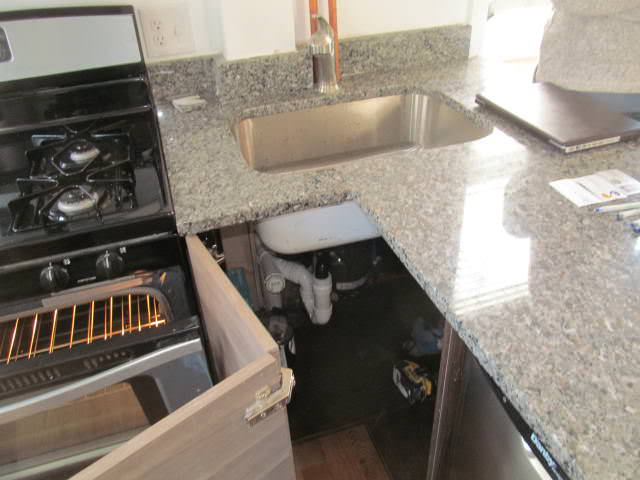

Rob Amaral Posted October 16, 2016 Report Share Posted October 16, 2016 this near the end of day after inspecting two houses.. one from 1840 with similar malarkey.. both with every 'wrong' in the book.. siding installed wrong, tar at flashings, weird plumbing set-ups, wiring foul-ups, etc... Download Attachment: IMG_2970.JPG 64.6 KB Link to comment Share on other sites More sharing options...

Tom Raymond Posted October 16, 2016 Report Share Posted October 16, 2016 The bifold door with clash with both appliances. NKBA design rules call for 18" of landing space on one side or 15" both sides of the range minimum. That's thousands of dollars in the dumpster. Link to comment Share on other sites More sharing options...
